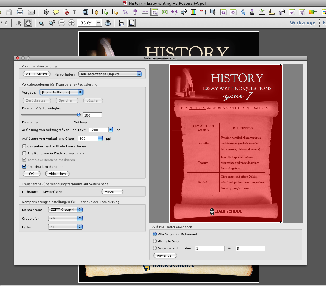

by just using AcrobatProX on MacOS 10.5.8, file size now 231,5 MB
is there any content on the five additional pages, or has the process simply inserted five blank pages?

In my experience with Acrobat X same thing happens when there is an error on flattening. Basicaly one page is not flatten and file saved with duplicates for all pages but the one which failed. And sometimes you see the messagebox with error and sometimes you don't
