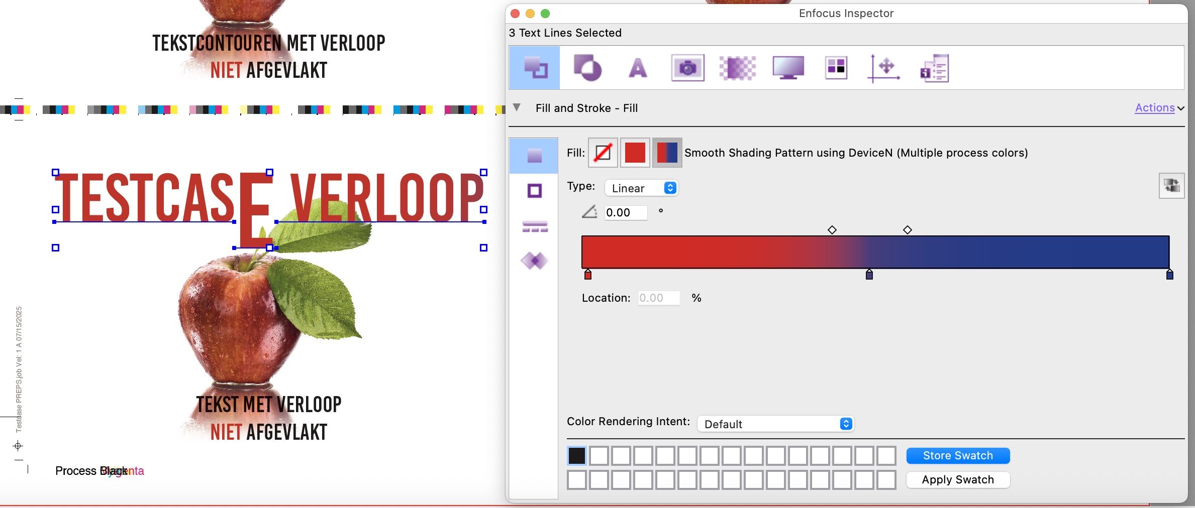

Interesting. When I inspected that PDF with Pitstop, it shows as though the text is still colored with the gradient. What’s also interesting is that if you look at the ‘OOP’ in ‘VERLOOP’, the color within those letters starts to get darker. It’s as though the center point of the gradient got moved further to the right (even though Pitstop seems to suggest otherwise).

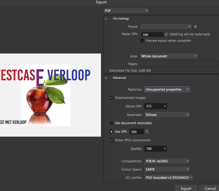

I tested a similar issue using Serif Affinity Publisher, and surprisingly, Affinity automatically converts the text with the gradient into outlines — without requiring any special settings. That said, I did notice there’s an option to rasterize unsupported properties.

I opened your file.
Unless I am really missing something, there isn't any use of transparency at all in the InDesign source file and as such, no transparency to “flatten” in any way.
Perhaps you are really equating gradients with transparency? They aren't. Smooth-shaded gradients which you use in your “Testcase Verloop” text have nothing to do with transparency and are not “flattened” into anything else. Smooth-shaded gradient support is a native feature of PDF 1.3 (inherited from PostScript Language Level 3) and for that matter PDF/X-1a.
There is absolutely nothing that InDesign is doing wrong in exporting your document to PDF.
(What you are seeing in your printed result, I obviously cannot confirm. But on the screen in Acrobat Pro and printed directly from Acrobat Pro, I see no anomalies!)
- Dov
PS: @Phideaux, what Serif Affinity Publisher is doing is absolutely wrong!! There is no reasonable basis to convert text with gradients into “outlines” unless you love degrading output. PDF does in fact support filled text rendered with smooth-shaded gradient fills!!!!
