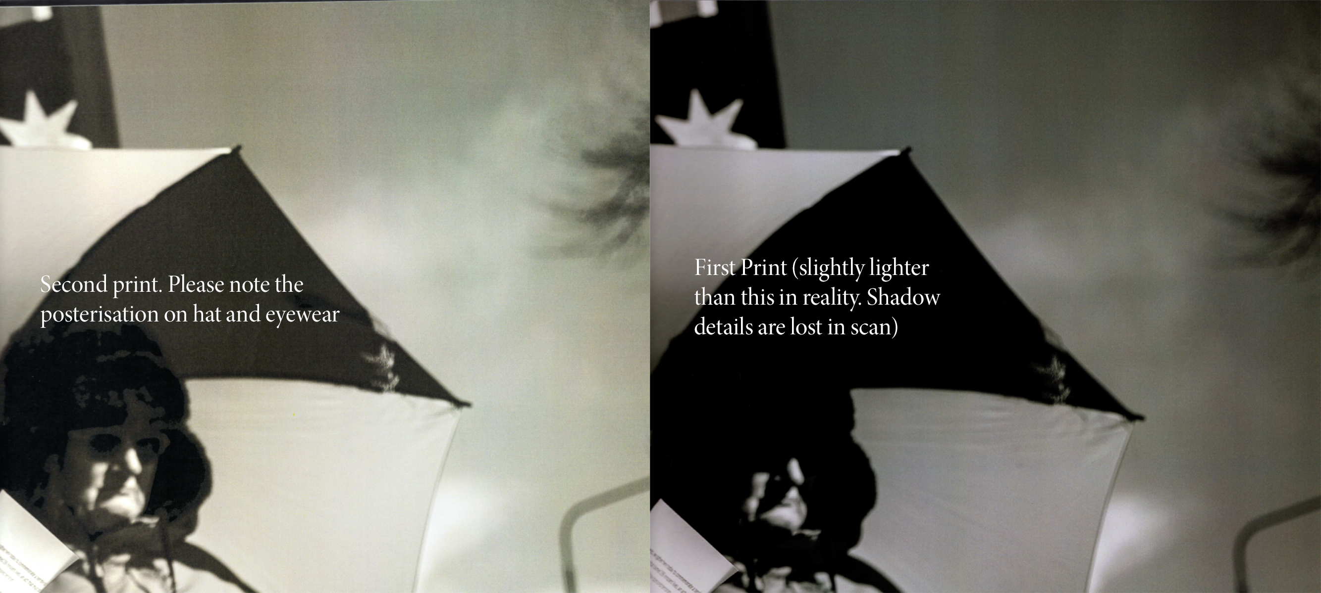

The second batch has a clear posterisation issue in the shadows. (Attachment shows proof vs final prints.)
The print provider claims this happened because parts of my images fall below RGB 10,10,10, stating:
“Abrupt transitions in dark areas can occur when subtle gradients fall past the threshold our presses can reproduce, causing dark greys to clip to pure black.”

  • Is their explanation (shadows below RGB 10 causing this issue) technically valid, given the results?
  • Based on the samples, does this look like shadow clipping, poor tone mapping, digital press posterisation, or something else?
I want to understand the root cause before adjusting files based on their guidance.

For this example, I prefer the 2nd print on the left, it has some shadow detail.
The first print on the right has no shadow detail.
An image with a 10 gray scale pixel would be about a 96% dot size.
A traditional sheetfed offset litho press would probably reproduce this as 100% (plug up, fill in). Maybe the digital term is "clip".
Test prints on "your" printer mean nothing, it has to be "proofed" on their production digital press.

- The darkness in that part of the photo (this is a small clipping of a larger photo) is intentional; I wanted it to be dark, as it's not the main subject.
- I understand the issue of clipping. But the problem with the left print is that the tone curve appears to have been manipulated. That is why I'm interested in finding out what has happened. I was happy with a "clip".
- I did the first print round with the intention of using it as a proof. I was happy with that, considering what can be expected from a consumer-grade print house - but they ruined it for the second print run.

Maybe you can send them a gray scale (continuous or stepped, 0-255 GL or 0-100% dot), have them print it, and then you will see the effects of their tone reproduction curve (compression, bumps, cutback, clips)?
