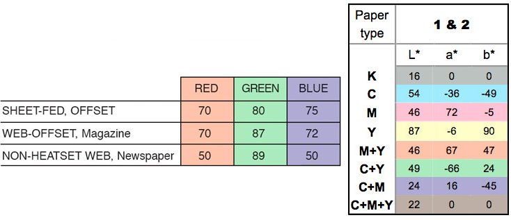

Below are the typical trap values (Status T, Preucil formula) for different types of presswork as well as the CIEL*a*b* values according to ISO 12647-2:
As noted, the ISO standard specifies that the chromatic inks are laid down in CMY sequence with K being either the first or last ink down. Traditionally, for most offset applications, the ink sequence has been KCMY.
