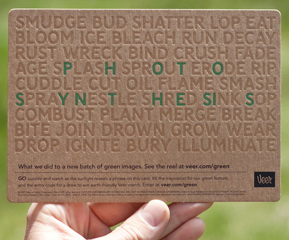

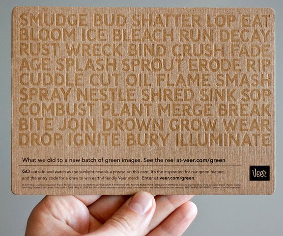

Photochromic inks
Arguably one of the most popular of the effects inks. Photochromic ink undergoes a reversible color change when exposed to UV light. The color change is immediate and reverts to its original color or becomes colorless when the light source is removed. This ink is available in wet or dry offset and flexographic printing.
Photochromic inks are available in colorless-to-color and color-to-color formulations.
Photochromic ink viewed under office lighting.
Photochromic ink viewed under sun light.
