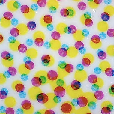

A related issue with how a flexo type plate prints is that the squeeze tends to push ink out from under the dots and forms a ring of ink. This ink ring can be thicker than the normal ink of the dot especially if the substrate is non absorbing and depending on the amount of squeeze. The thicker ink of this ring will often change the hue of the printed dot. So compensating for only dot gain might not get the results one might want.
The doughnut of dread.
Something like this
