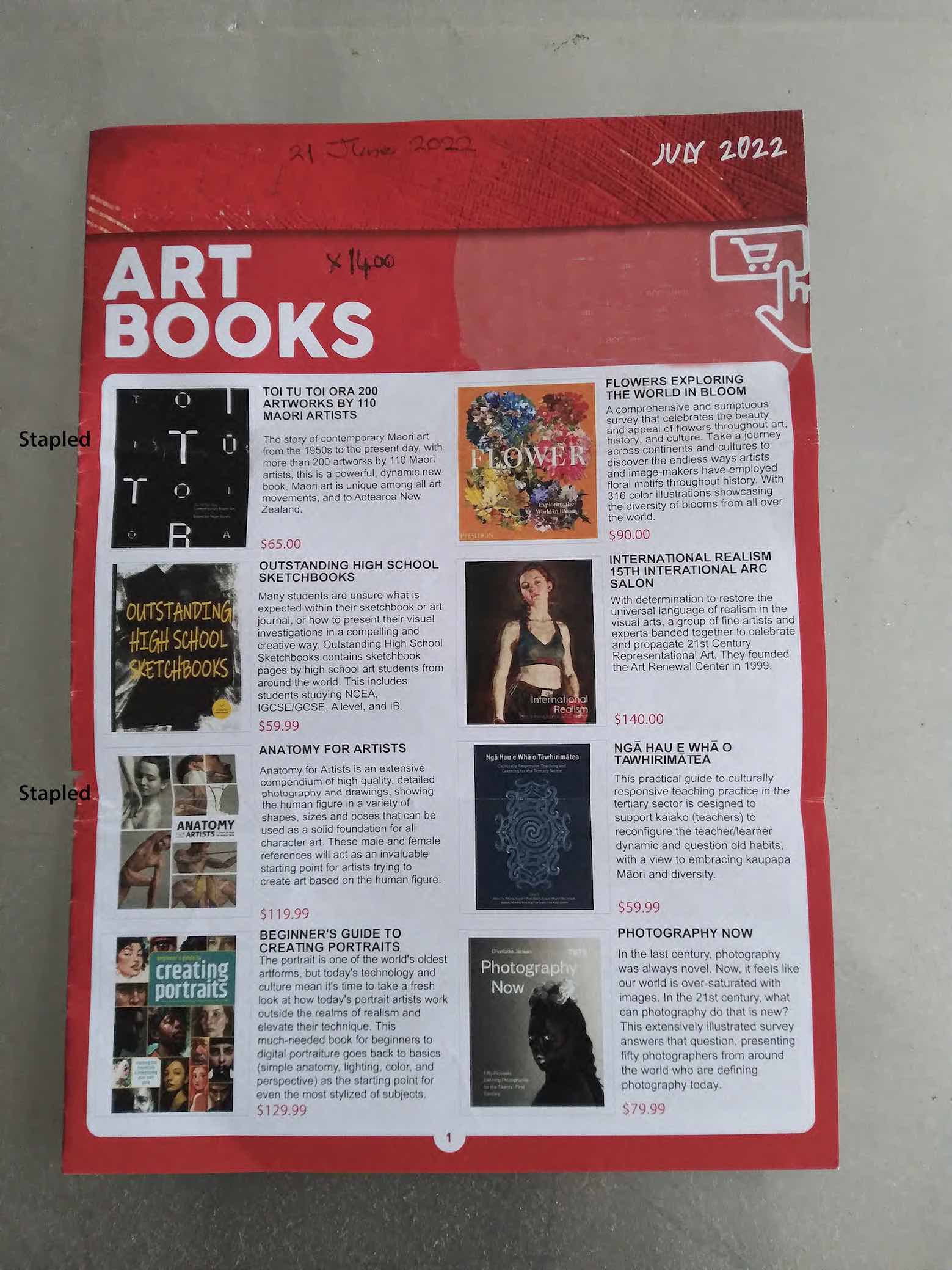

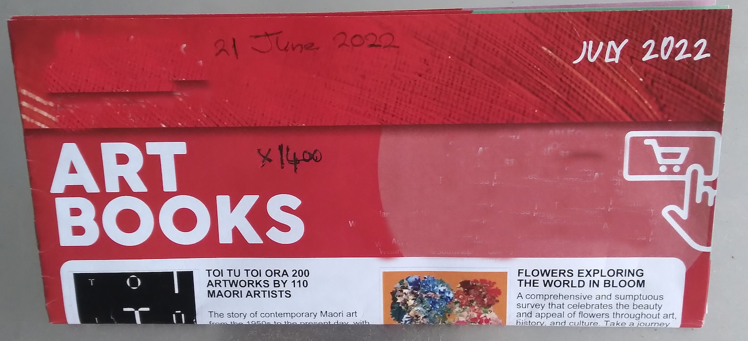

Thanks for getting back to me. This is just a regular saddle stitched booklet. (Staples are on the spine as per normal). I'll attach some photos in the thread.

Photos attached.

Thanks for the info. My Duplo won't do a three-panel fold. (Its a DBM-120 booklet maker rather than a folder). It looks like I'll need to buy some more old machinery (my wife will be over the moon:)
Photos attached.
Now I see, I got that one completely wrong. My brain didn’t do a good job on the size conversion. That’s a tough fold.
