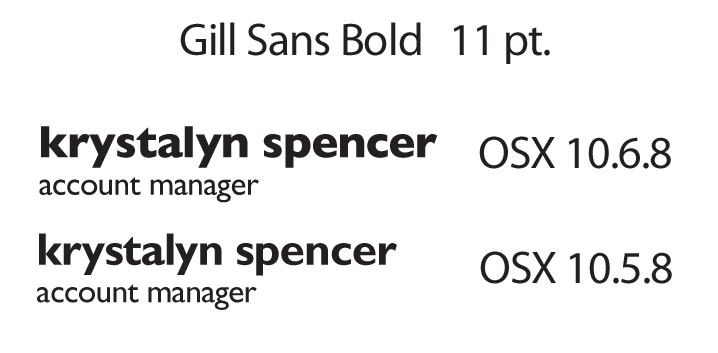

So... I'm trying to figure out if there is ANYTHING that I can do to rectify the differences that we are getting between my old machine (running OSX 10.5.8) and the new machine (running OSX 10.6.8)
The offending font is GillSans Bold, which is coming out much bolder and therefore 'wider' on the new machine. This is making everything not match the samples of previously printed jobs and making me crazy.

I may screw this up but I'm going to try and insert a pic of what I'm dealing with. ;)
Thanks guys!

that almost looks like two different fonts. you might check the creator of the font too. it's possible that got switched. a lot of printer manufacturers in the old days used to have supply their own versions of some of the major fonts. it wasn't rare to several versions of palatino or helvetica, and have some of the, in the get info, have a creator of "Hewlett Packard."
and though it should happen to that degree, fonts are updated every now and then just like other software. it possible, but i woulnd't bet on it, that something changed. but that's a pretty substantial change.
I packaged all the art and fonts from the old machine and am using those on the new and this has worked out really well with Document Fonts folder which Indesign activates upon opening the file. So... both of these images are using the same version of the same font. Fun, huh?
This is basically what I've been doing on everything that is based on existing accounts since last summer and gill sans bold is the ONLY font that has become overweight in it's new home. Gill sans regular looks just the same on both versions.

Do you have other copies of Gill Sans running on either machine? While the document-activated font is supposed to supersede any other fonts available on the system, this looks like a way to drum up an old-fashioned font conflict.
holy crap! That was it. there was a dfont clashing with it. :))))
