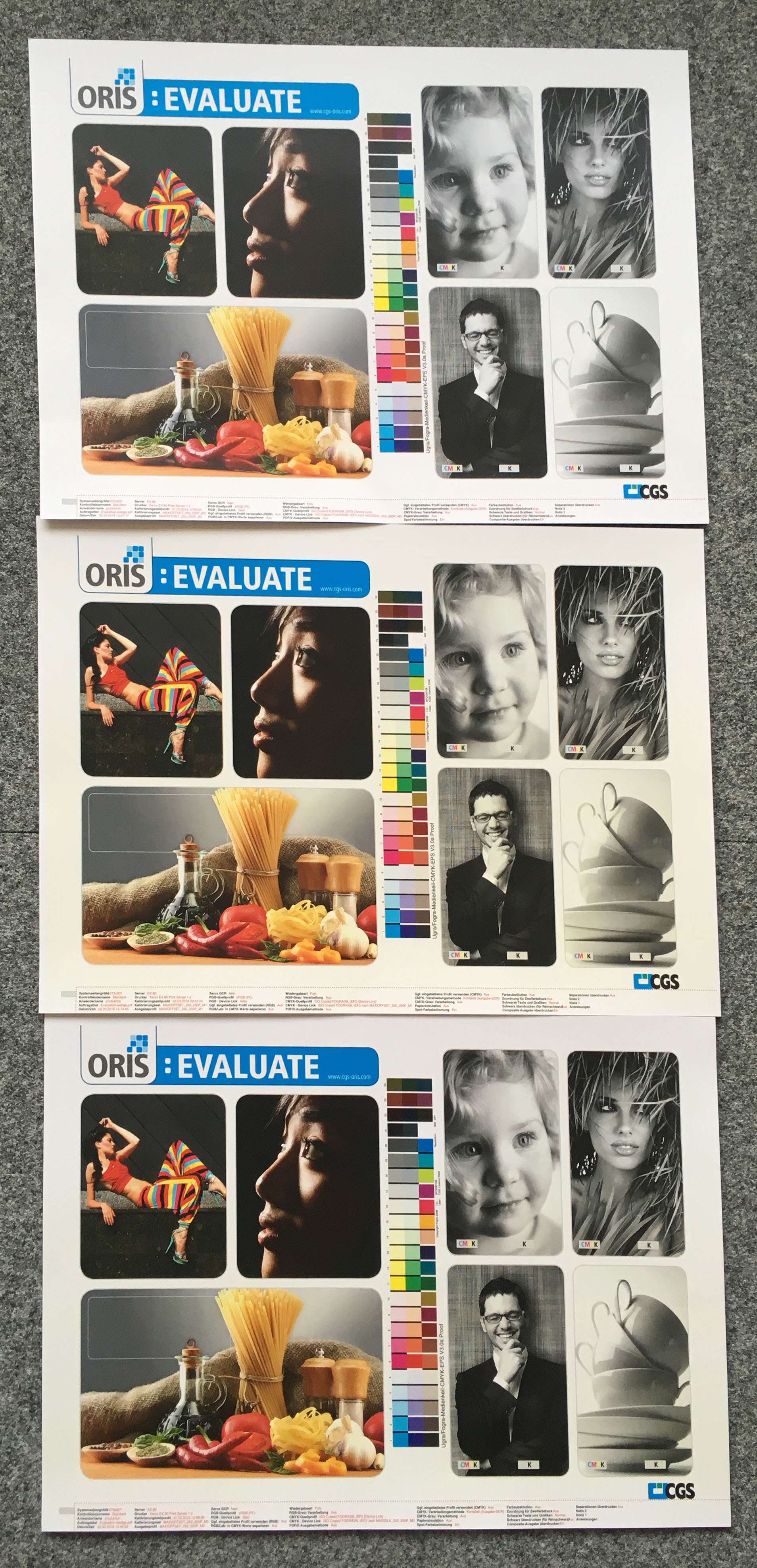

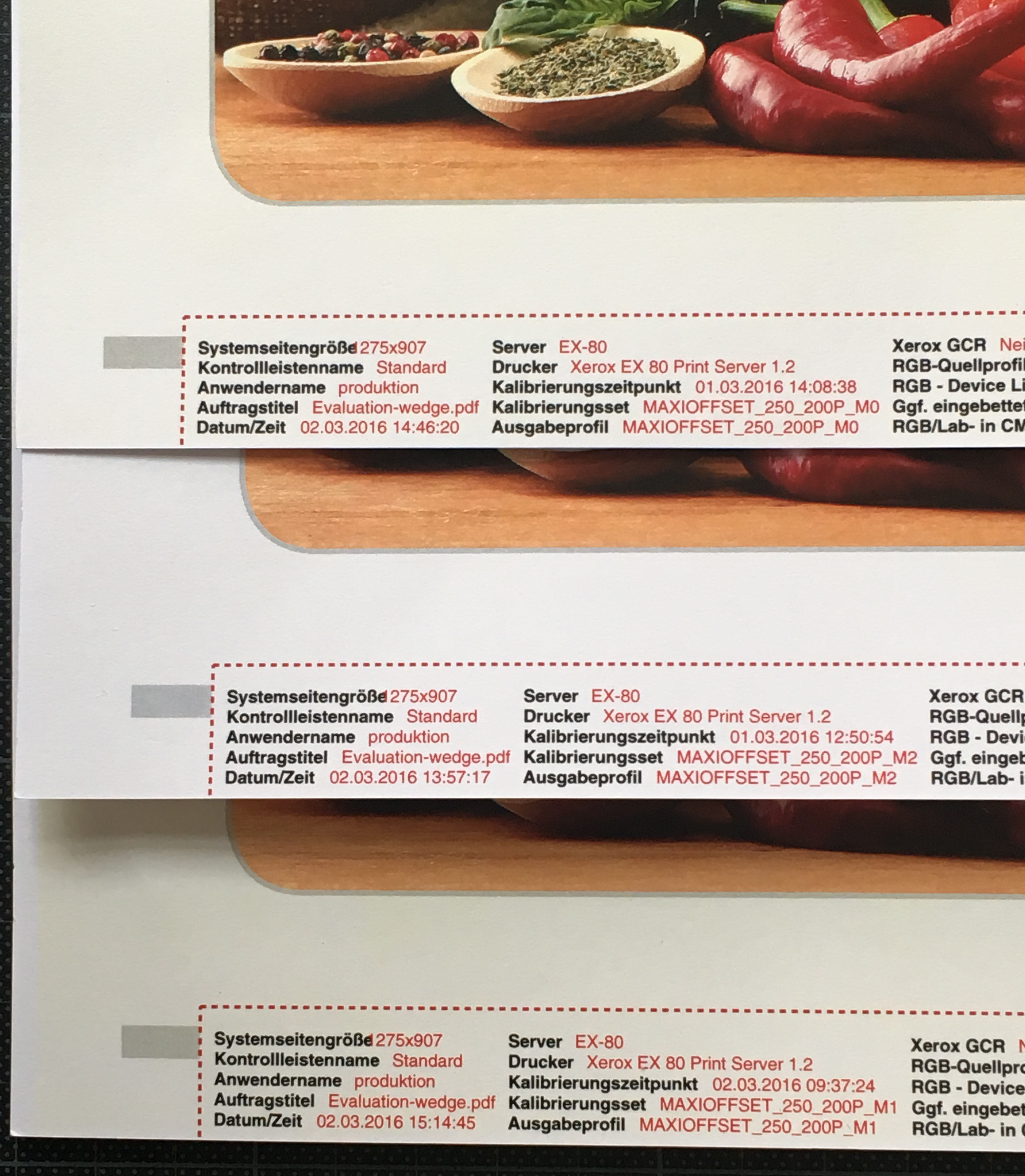

Postscriptum: sometime strange things happen :). As part of a students examination we have discussed and tested the influence of measuring modes last week. Using some really cheap offset paper on a digital press (xerox versant 80 with an efi controller) we have done M0/M1/M2 with an i1Pro2 while all other parameters stay the same. Guess the two pictures speak for themself...
