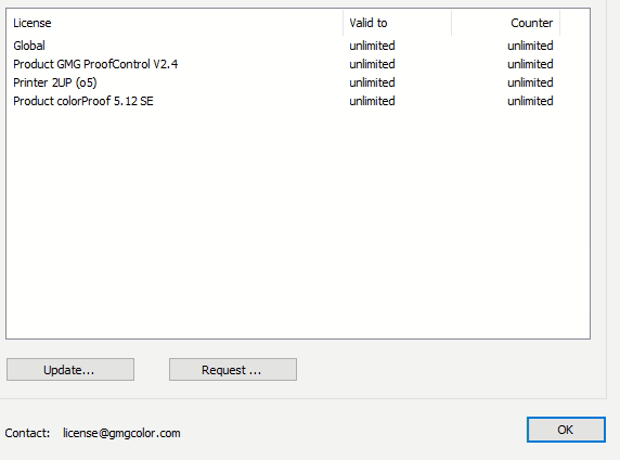

I change my Epson from SC-P5000 to SC-P5000 buy now he have the internal Spectrometer .
All the GMG software is working like before , but i would like to have the certificate printed on the proofed job , is this possible ? Do i need any special license to get this printed on the sheet ? See the image with my actual enable keys . I read one information that we need one license for inline spectro . Is this true ?

I think that you need a license called ProofControl Inline (PCI), contact your GMG reseller.
Another License !! Its a bit strange because i can the paper calibration using the internal spectrometer and to print the certificate i need one extra license ! This dont make sense , but ...it should be one way to get it , because i can see the proofer doing the measuring of the UGRA target, but is not printing the report on the paper
