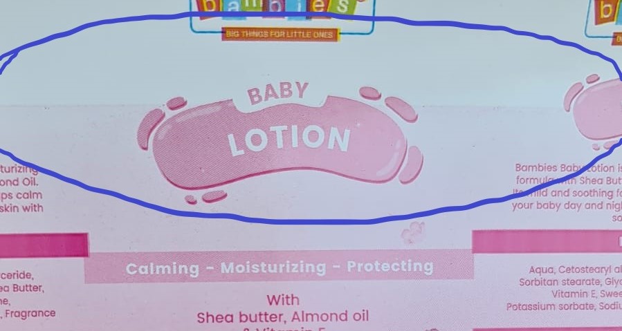

Need to know how you guys work with gradients in flexography to prevent edge lines and smooth transition to white?
Adding a picture of a job where we had issues with the edge line at the end of the gradient.
Not really the strong point for flexo.
Either try to keep everything at 1%, dont make a complet fade out
Use special RIP-like Samba Flex
Decrease Lineatur
Use a second weaker color for the highlight area
Productionwise you always also have the bump up for the specific plate and plate thickness. There you could try to switch to a better suited plate and use foam to decrease thickness and have a more stable mindot.
Often occurs with converntional AM screening.
If you use a hybrid (XM), where dot is FM in highlights, then goes back to AM later (>10%), this would help.
The visual appearance is a smooth vignette or blend to zero.
Lightness is not from smaller AM dot, but from farther spaced dots.
