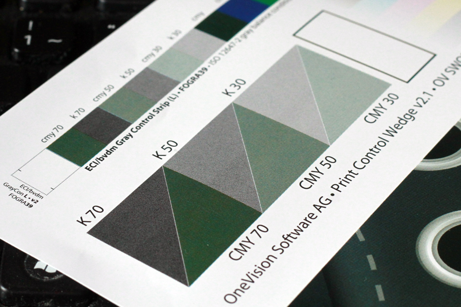

This is where the PROBLEMS BEGIN, on files with NO or little optimization the printer told me he could not avoid the GREEN overcast on gray balance fields, without comprimising the color quality of the test pictures below. He told me he tried fixing the gray balance but if he cought the right balance with little to no overcast on CMY test fields the test images would look horrible, so he kept the way images look and left a green overcast on gray balance fields.
Below is a picture where the problem is at its worst, you can see the green overcast on the CMY fields. This is the print from the plates with LOWEST amount of GCR. In the prints with higher amount of GCR there is less of a green overcast, somewhere even none.

So with my knowledge i have come to this conclusions:
- I wasnt in the print shop while the printing was in process, so lack of effort and a simple quality print would solve this problem. (printing was pro-bono, if that makes any difference)
- A problem in pre-press, although everything went according to standard, nothing i would notice went wrong.
- Logical explanation is, the amount of C and Y ink is excessive so a green overcast is formed, again i checked the plates and files from the RIP and everything is in order, so not a pre-press issue.

1. Actual SIDs for the upper image with little optimization (2/10 level in asura) are as followed:
C 1,54
M 1,39
Y 1,13
K 1,72
Which is pretty solid. I dont have the LAB solid values at hand right now.

RE: 5. Those sound like SIDs copied from a spec sheet. What were the actual measured SIDs as printed on your test form? And can we assume a KCMY ink sequence?

Actual SIDs for the upper print with little optimization (2/10 level in asura) are as followed:
C 1,54
M 1,39
Y 1,13
K 1,72
the SIDs below with + and - marks are what they aim for when printing sheet fed coated, so yes they are gracol coated paper spec SIDS.

Missed those numbers.
Your densities for C and Y are high relative to M - that may be your problem right there. Are you measuring Status T or E? (GRACoL would be status T) GRACoL densities are actually:
K 1.70
C 1.40
M 1.50
Y 1.05
You can see how much higher the actual M should be relative to C and Y.
Not the:
K 1.7
C 1.45
M 1.45
Y 1.0
Targets you quoted.
And not the:
K 1,72
C 1,54
M 1,39
Y 1,13
You actually ran at.
And see how low your actual M is relative to the GRACoL target?

All in all, as @gordo said, the densities for C and Y are high relative to M which in the end causes a green overcast on the gray wedge. The more black added at higher levels of GCR the easier is it to control gray balance as their is less harm if the C,Y densities are higher because theres much less C,Y ink on the grays.
I see this as the most logical explanation, doing projects like these teach and challenge me the most (im still a student and a part time worker in a printing facility).
