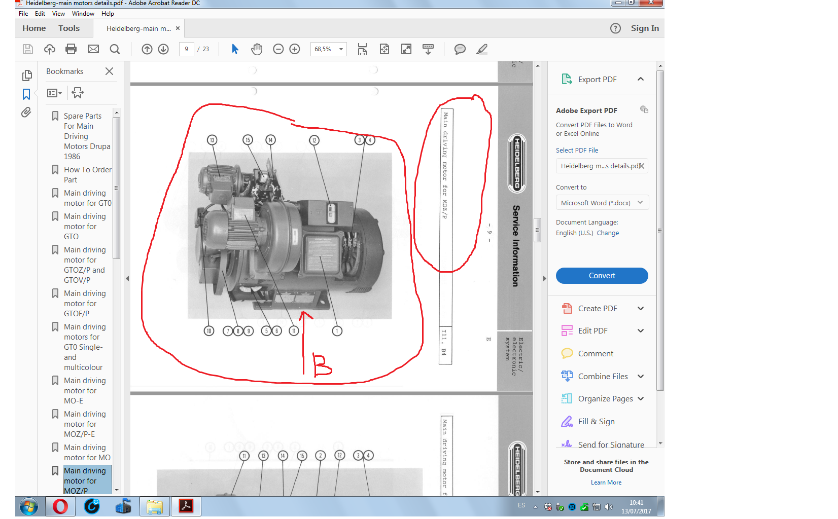

Dear Sir:
I did check, you must test the Power supply for the MRK.
the number 1501 is can be defective MRK, SVK3, or TTK .
SEE the attachement measure 37VCA with DMM, and after +48Vdcfrom GRM24(2) FOR the board TTK.
Test the filter 15Z1+15Z3 .
tHIS TEST is for determine if the Voltage for MRK is o.k
Since you can have erroneours signal from SVK3 A mrk(Board for main motor)
or TTK defective from BLT
lET ME Know how is this step voltage are in the range or out.
I can guide you.
Blessing
[email protected]
