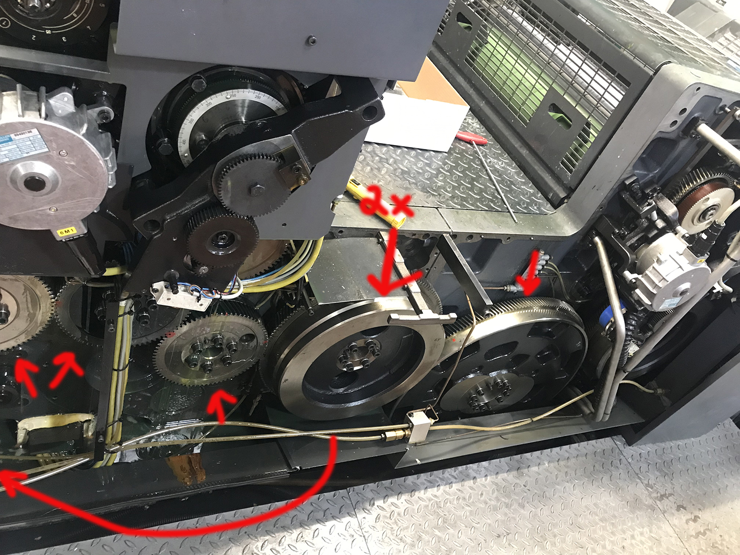

Does anyone know a place that parts out older Heidelberg presses that are decommissioned? We have a SM-74 that has two large Gears in the last 2 units going into the Coater unit missing teeth from something that fell into the gears. The press is running but is sketchy and we wanted to see if we can find 2 new/used gears to have them replaced. Did a little surfing the Net with no luck. These are the Large gears that drive the cylinders about 24"-18" round 1.5" deep. Any suggestions would be appreciated.

Looks like 5 gears in total. I have numbers for 3 right now. M2.505.870 / 53.005.280 / M4.005.870
Any idea on availability and prices.
Model: SM74-5-P3+L
SN: 623697
6 GEARS: M4.511.280 / M2.505.870 / 53.005.280 / M4.005.870 (2x) / M2.011.870
OHIO, USA

Be aware these gears are often tolerance parts. There will be numbers on the gears stating what tolerance range they fall in. If the gears installed do not match this, the backlash will be incorrect and will cause more damage to the gear train.
