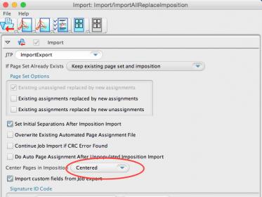

I need some assistance with Preps 5. I'm setting up a generic imposition for proofing. I have a 11x8.5 template with a blank page in Preps and I import this imposition in Workshop where I can assign a file of any size to it. The problem is that the assigned file is not centred even though my blank page is centred in Preps. Any idea? Thanks!

In your import processing template in Prinergy set it to Center your pages as shown in the attached image.

OKLP:
1. Do a"Get Info" on the page in the Preps run list. There will be a"Position Adjustment" pup up with a centering choice.
