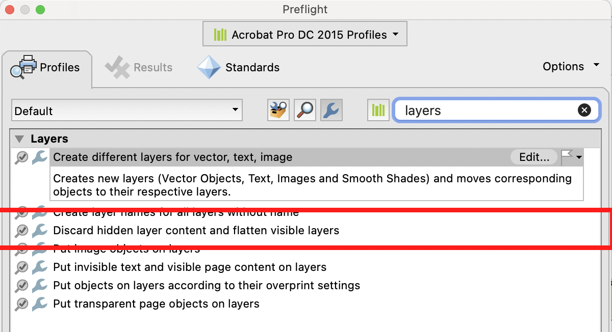

You could delete the layer (Optional Content Group) if you use Pitstop. If you don't have any type of PDF editor you could go to your layer while in Acrobat, select the layer and under layer properties select never exports. Then export your pdf as postscript, then distill. Your layer and all content should now be gone and you can drop in your hot folder.
You just needed to flatten it in Acrobat, that would have done it.
Nice, I learned something new! I tested this on one of my files that I place a fold marks layer onto for customer supplied pdf's. I don't have an issue with the layers but I may in the future so this is good to know that it can be done right in preflight.
