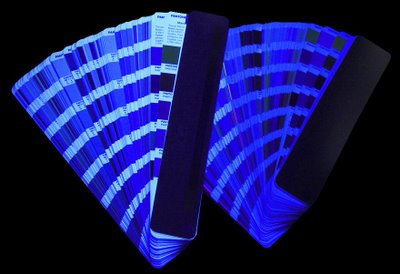

It's not just the Pantone inks - it's also the paper they print on. I don't have the Pantone Plus swatchbook but I did check Goe vs the original and the Goe has a much higher level of OBAs which will impact the pastels (see attached blacklight view).
IMHO, you need to determine what the target for color is - your swatchbook, your client's a Lab value, a previously printed sample etc. Then proceed accordingly.
