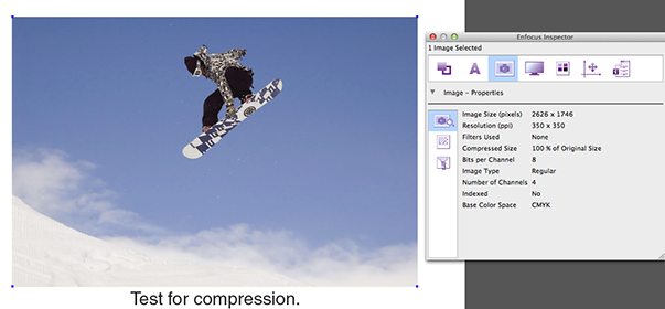

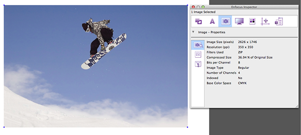

Here's the scenario:
1) I have a PDF exported from ID CS6. The image are not compressed (this is intentional).
2) I open the PDF in Acrobat X and delete a line of text.
3). I save the PDF (File - Save As - PDF).
4). The image in the PDF now has ZIP compression applied.

That is correct. Because you did a Save As, which means you've told us that we can perform any form of LOSSLESS optimizations on the file when we create the new COPY of the file. If you only want the changes you made applied, do a Save.
I went through all of application prefs and couldn't find anything that changed the File-Save As-PDF setting. Is there a fix?
Nothing to do fix. It's by design. And has been this way since Acrobat 3, when we introduced optimization.
