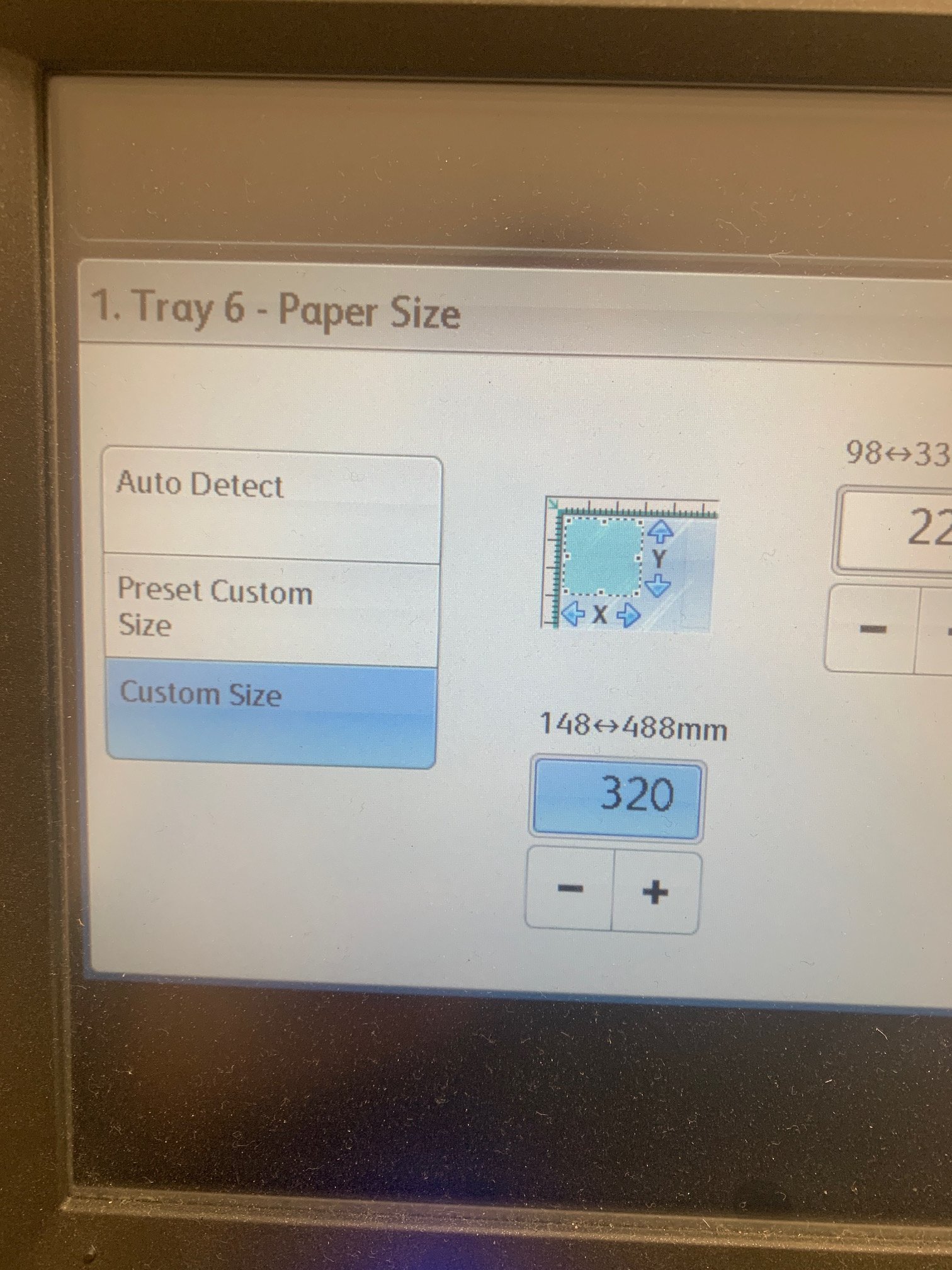

Printing a lot on SRA4 (225x320mm) sticker paper at the moment and the Versant 80 doesn't auto detect the correct size as it doesn't have SRA4 as a set size. So, I'm having to set a custom paper size each time I put SRA4 paper in the printer.
There's a button as shown below for 'Preset Custom Size' but I can't figure out how to store custom sizes in there. Does anyone have any idea?

When logged in go to
Tools >System Settings, under Features column >Paper Tray Settings > Preset Custom Sizes (should be on second page of options)
Once you have your custom sizes setup you don't really use this setting too much, I had to be in front of the console to get to where I needed to be :)
Thanks so much both of you, I’ve managed to do this now and will definitely be printing the steps to do this in the future :)
