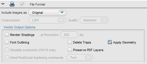

we're splitting a job between two locations. Files get processed at one location for approval, then export to PDFs for printing at the second location. The problem is the exported PDFs don't have all the reductions and offsets that were done to them at the first location. Is there a way to export to PDFs while retaining all the adjustments?
while exporting pdf's do you turn on "apply geometry"?
And just a thought - if second location have prinergy also, you can export whole job
