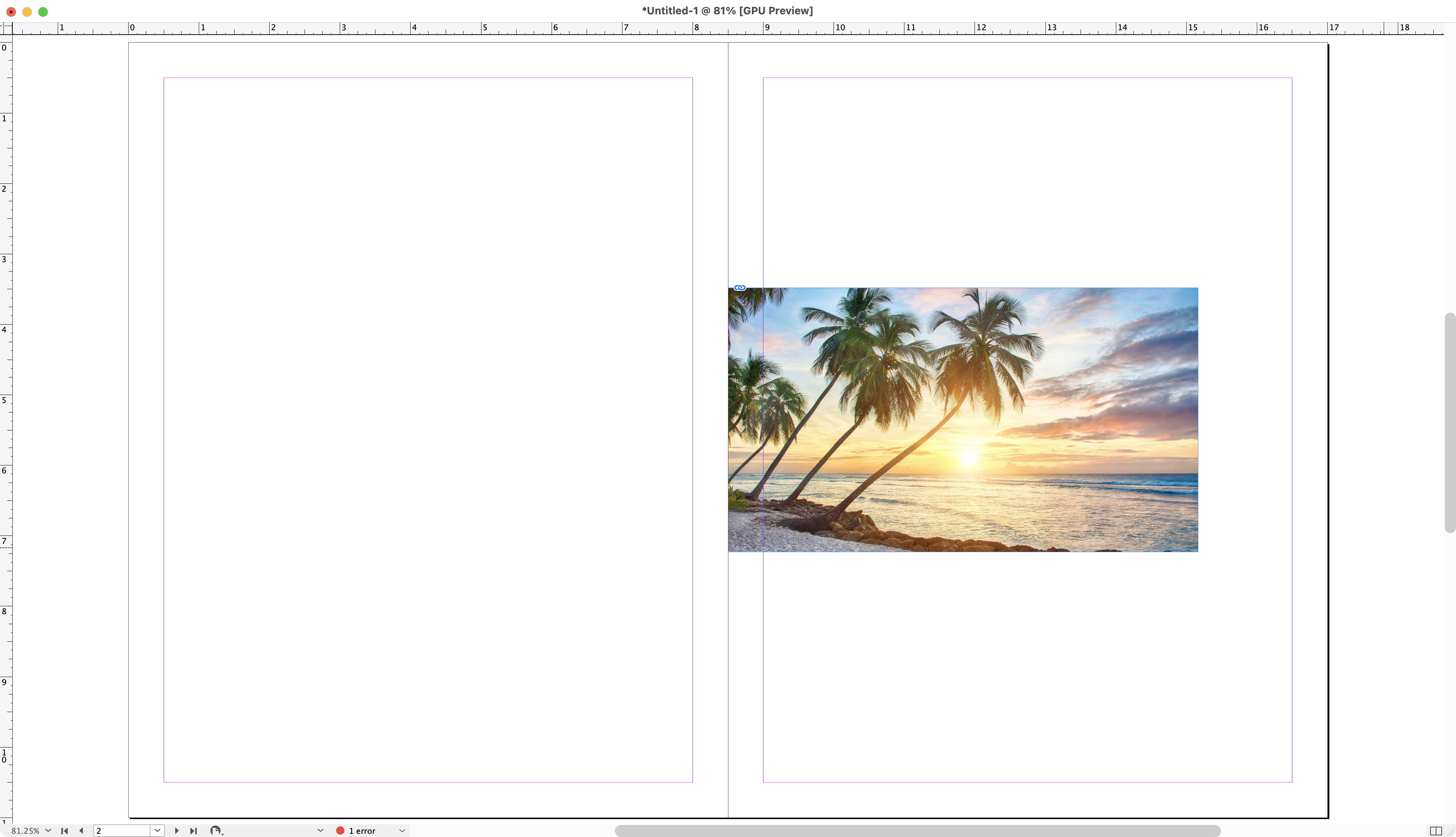

Hi Mike,
Please see below. Since the image stops at the fold and this would perfect bind, the pages need to be separated so the image can bleed off the left side of the page.

Hi Mike,

I see what you mean. Normally it shouldn't be a problem, however, because that area is going to fall into the gutter of the book. Most of the time anything within 5-10mm (depending on book thickness) will fall into the gutter and not be able to be seen anyway, so you wouldn't even notice it. If the perfect bound book is super thin for any reason, then setting up your InDesign file without facing pages on would be a good idea.
