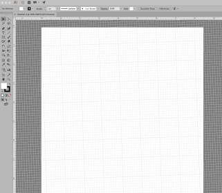

The grid (view /show grid) is not square to the document page it is angled. If I place something, draw a shape, or add text it gets placed at the angle of the grid. Not square to the artboard. See attached screen shot. Has anybody seen this before? How can I get the grid back to square.

Yes closed and reopened document. Closed and restarted Illustrator. Restarted the Mac. Created a new document and the same angled grid is there. Can't seem to find anything in preference settings. Strange...
namelessentity. Thanks that's the info I needed! In my case it was the "Constrain Angle" setting in the General Preferences. Mine was 2 degrees should be 0. Didn't know it had to do with the grid. Thanks again for the help.
