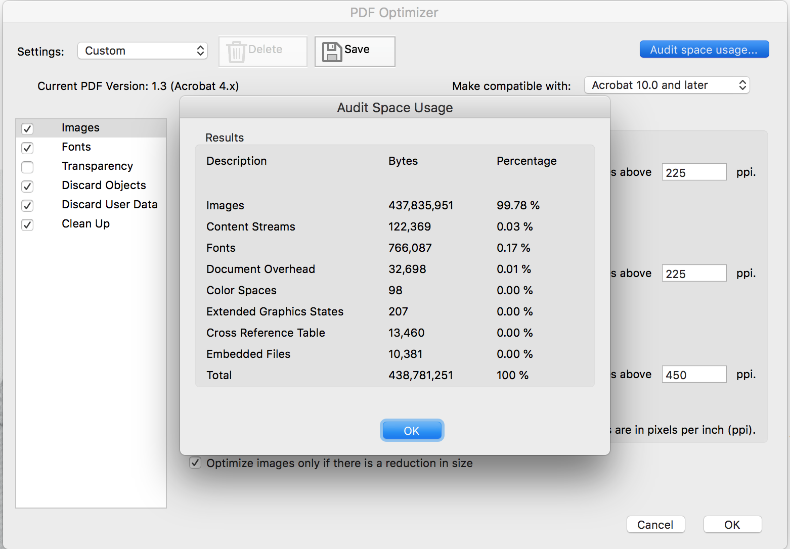

Open your large and small pdfs. On each, click File>Save As Other>Optimized PDF. Then, click the "Audit Apace Usage" button. This will help see where your extra space is coming from. It really depends on what effect are being preserved, color profiles, and etc.
Hi Justmike,
I tried comparing the files using the Audit Space Usage, but the point is that on all the other PCs, the preset is exporting with exactly the same size, except on this PC, the two files have different size.
I am pretty sure, no matter what is preserved, the same preset can not exceed a 2 mb difference on my HDD. And this file is jumping from 8mb to 40mb :(
