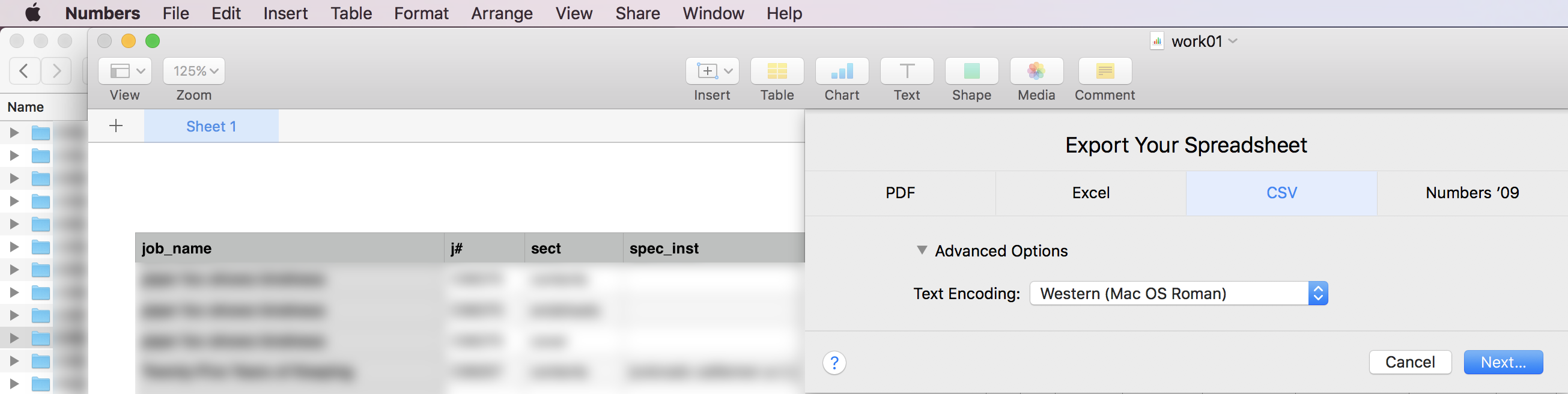

the default “unicode(utf-8)” text-encoding may need adjustment to “Western Mac OS Roman” … this is applied, under “advanced” options ("numbers" program), when creating *.csv file for indesign's data-merge utility.
edit:
this is not configured in mac-os system prefs … see screencap below:
