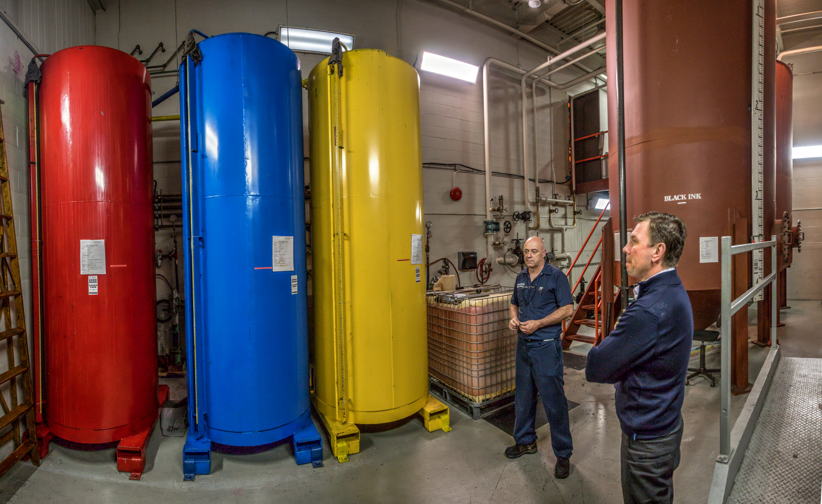

For those who haven't seen it - this is what the ink containers look like for a coldset press with a newspaper print run of about 20K copies a day - so not big runs.
The ink is delivered in tanker trucks.
