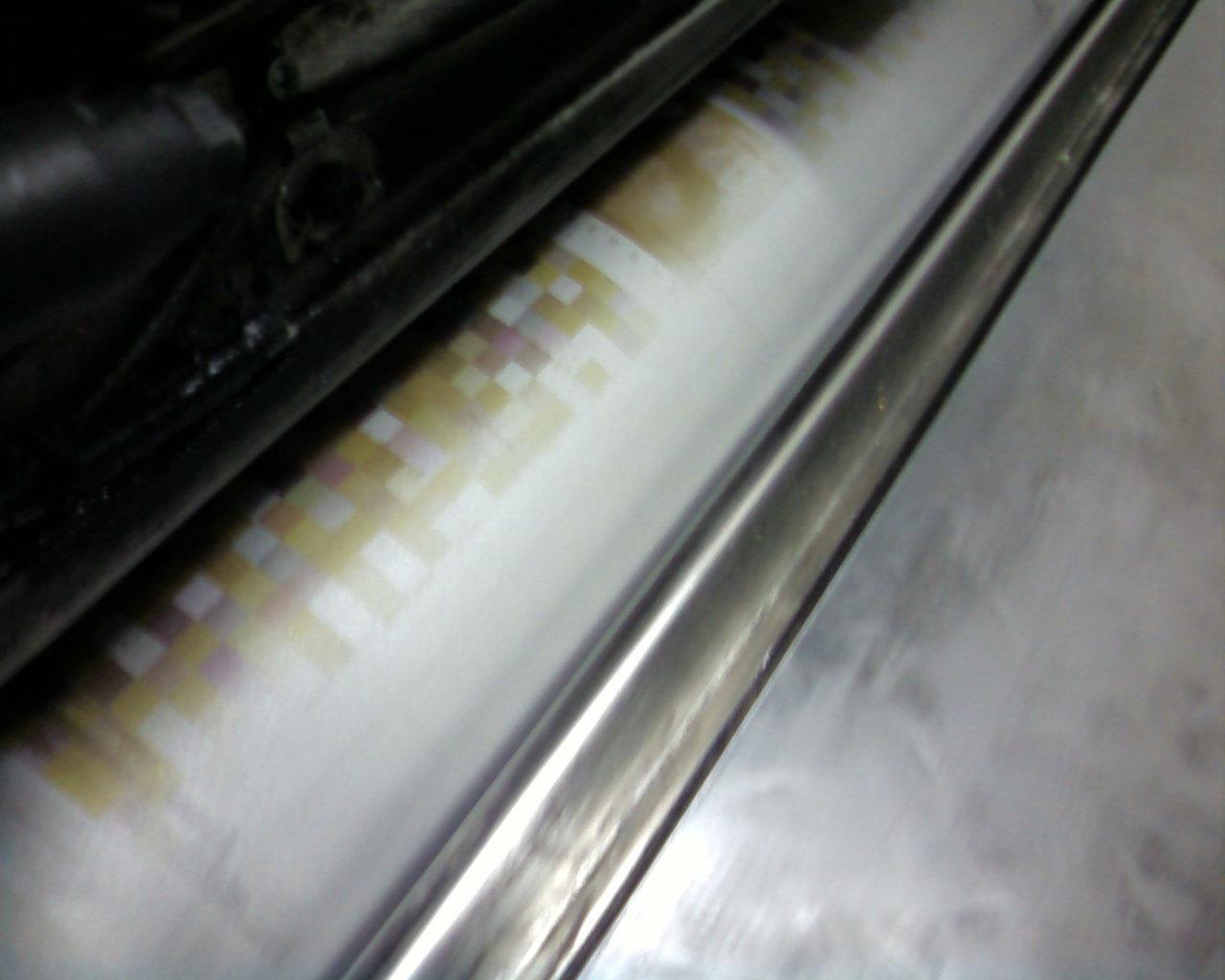

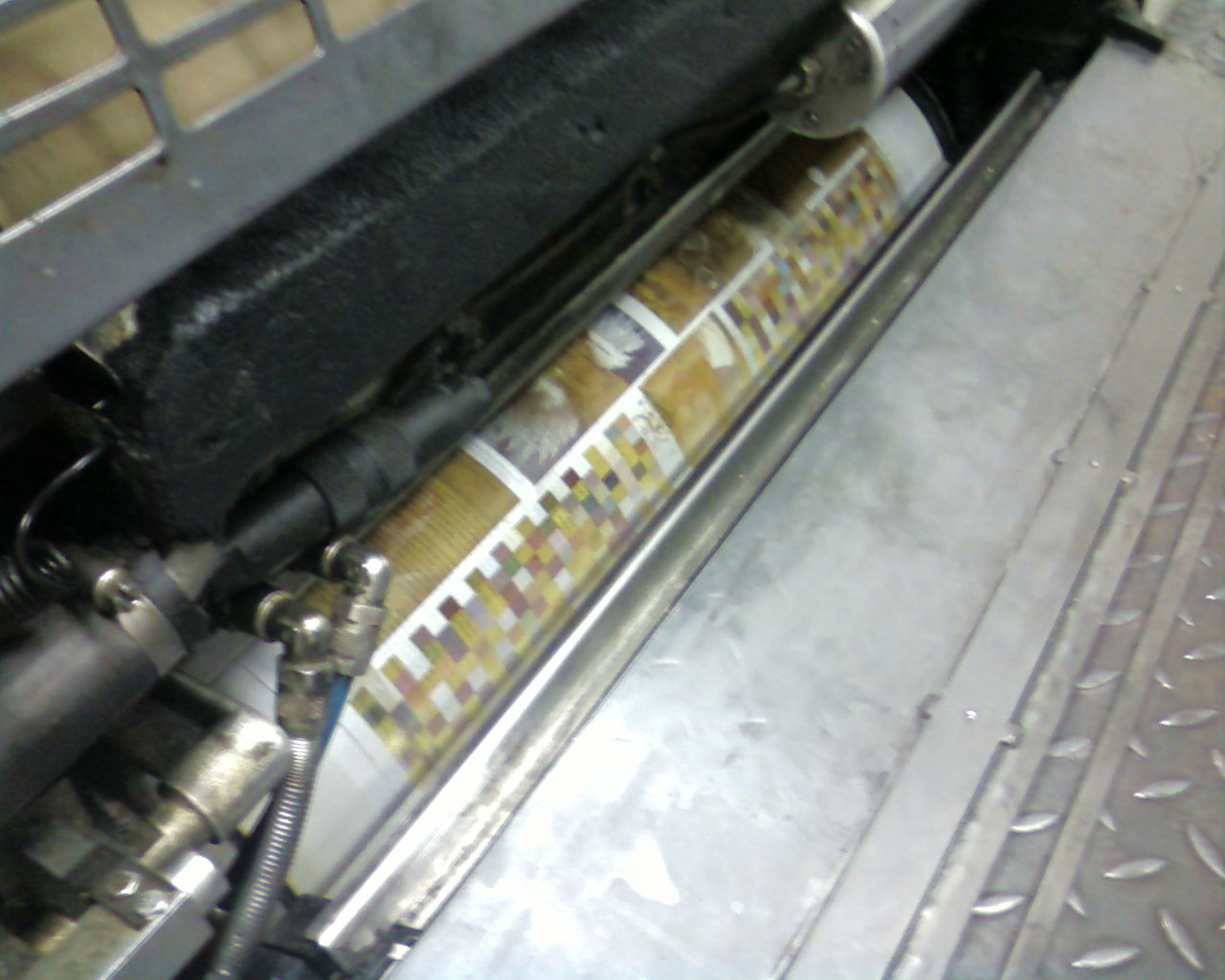

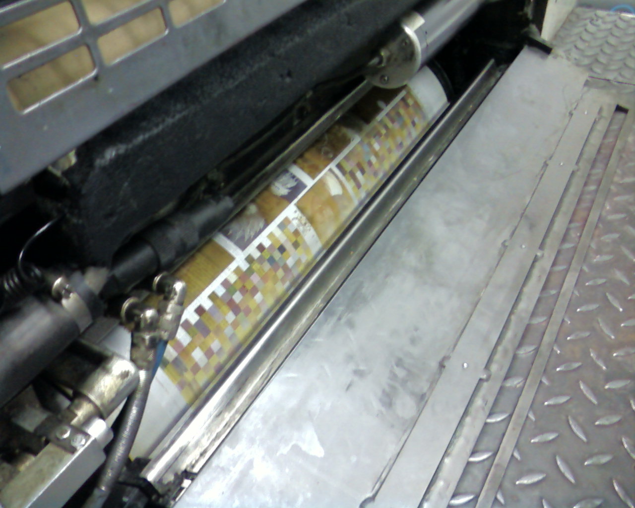

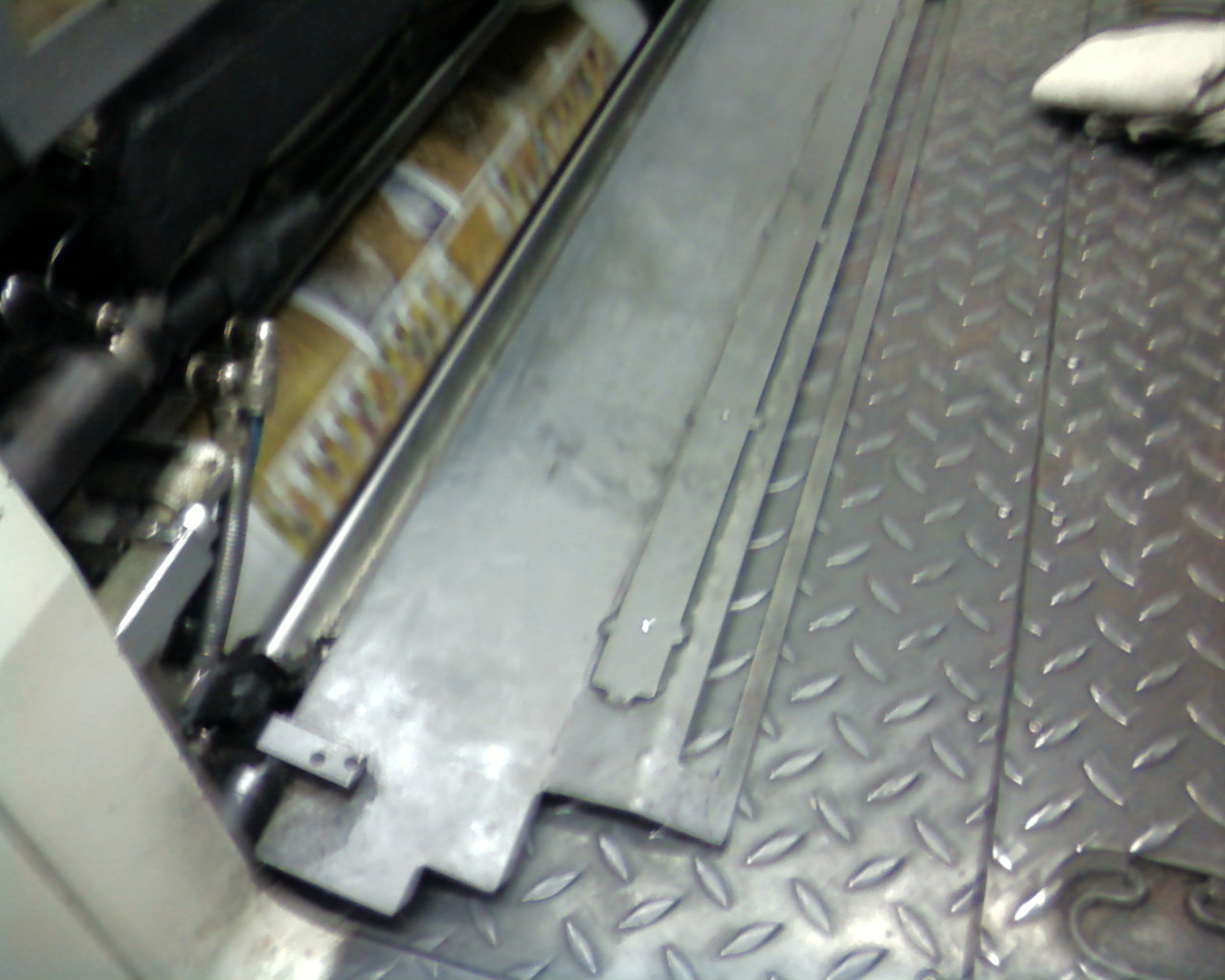

we've been having issues with our ink for a while now and just recently switched inks. we decided to re-fingerprint the press in the process, to make a long story short, i found that unit 5s impression cylinder has a very solid imprint from the blanket. dark enough to read, shiney so on and so forth. only thing is, it's only about 6 to 8 inches up from the gripper.
packing is correct, blanket is correct, all is torqued properly and the unit is printing correctly.
pre-mature impression? impression not disengaging on time? theres no setting that i know of to change impression timing.
anyone seen this before?
i've attached photos and a video link.

He is printing image onto his backcylinder,so the prees is staying on impressoin after the last sheet had cleared the unit.

The issue on heldebergs is the impression rams, the seals in the pistons go so there is a delay on coming into and of preassure, on heidelbergs you can get the seals renewed, i have had this a few times now and it starts with a 1inch band of impression on the back cylinder and gradually gets worse.

yeah, 67drake, thats mostly what i was thinking. i was looking at it again today and it's definitly late coming off. like paultheprinter said, it may be the impression rams. i'll have a look at them tomorrow and see if anything is visibly wrong.

Anyway,I talked to our other inhouse mechanic,but he came to us from Heidelberg,so that's all he knows. He said along the lines of Paul. He said if your rolland is anything like the Heidelberg,you will have pneumatics to drop on impression,and another to force off impression. If your pneumatics for pushing off is getting lazy,it will stay on for a short period too long. He said to check if it has a solenoid for actuating the "off",the Heidelbergs have a button to push on the solenoid to manually operate it.See if it does anything when pushed. Also check for airleaks in the lines to and from it. But,as I said,this is assuming it it similar to Heidelbergs set up.

The impression off/on is in two stages. First against the plate and then to the impression cylinder and the reverse sequence coming off pressure. There is a delay coming off impression, the air cylinders might be getting lazy or something has happened so the signal is n't getting there in time.
