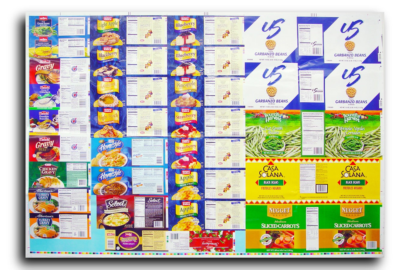

Is it really more cost-effective to try to mange a seven-color offset press than to just ink up a unit or two and run spot colors?
Yes!
The offset installations that I have had experience with may have a 7 color setup but they typically run a six color setup. I.e. they don't have 7 colors on the press all the time.
They pre-plan jobs to run C,M,Y,K,B/V,O/R for a shift then replace the V with G for the balance. I.e. one washup and ink change over.
They'll often run the brand color as a line color rather than a screen tint blend (depends on the brand owner). If the brand color is out of CMYK gamut they may use it as one of the extended process colors - i.e. instead of the V/B, O/R, or G.
They typically run gang label/packaging jobs this way. There are many business opportunities that arise by working this way.
It is an extremely cost effective production process and VERY profitable. It is one of the main reasons that, when I worked at creo/Kodak, none of our customers would provide a testimonial that we could use in marketing our EG solution despite those printers running the EG process 3 shifts a day, for years, on hundreds of thousands of label/packages globally.
This is an actual live production sample:
Click image for larger version  Name:	Ganged H.jpg Views:	0 Size:	436.2 KB ID:	287787
