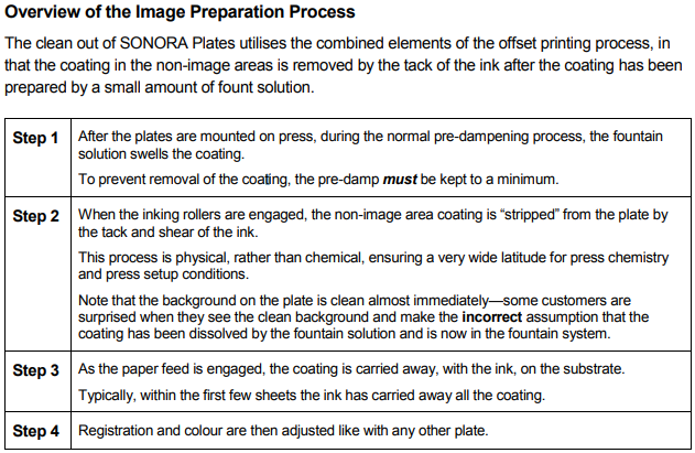

when kodak representatives sold you Sonora, did they have some white papers on best practicies with those plates?

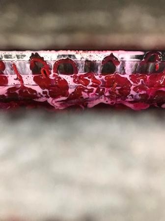

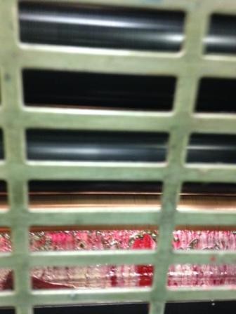

Another factor that MUST be considered, but surprisingly one that has such little discussion about on this forum is..... the dreaded calcium. Quite possibly, the most debilitating non-mechanical issue there is.
DOP plates are EXTREMELY calcium sensitive and magenta ink has a good bit of calcium in it, not to mention the paper or board. UV ink is very calcium sensitive. The calcium is rooted in the rollers and affects so much. Removing the calcium is critical.
It can't be done with your home remedies, your vinegar, your pastes and all the placebos you use or buy. Once the calcium is gone, really gone, many things fall into place. Old ink and paper lint are purged once the calcium that encapsulates it is gone.
Photos of two magenta units. One from a 40" Komori running UV ink and one from a 57" KBA running conventional ink. Both presses experiencing much of what ails your shop. The white foam is calcium. BOTH presses have reduced so many process problems since they have started attacking their calcium problems in earnest with an effective solution. Don't underestimate calcium contamination, obliterate it.
Revolution, I would love to see pictures of your roller train. Calcium may not be your only issues, but I am willing to bet it is a big part of it.

Yes, we are aware of best practices and have 7 years experience with the processless plates - Thermal direct and Sonora XP. White papers are also delivered, we had few trainings in Osterode, Germany - Kodak factory and laboratory.

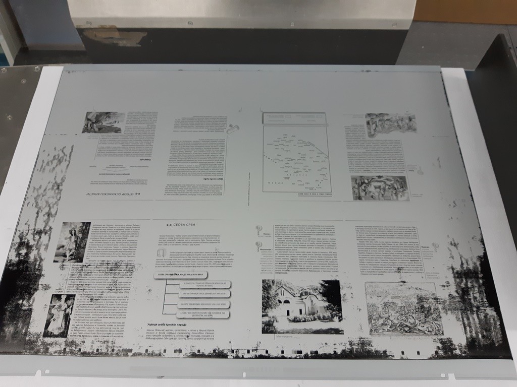

6) Notice the images with comments on last stage I got two days ago...

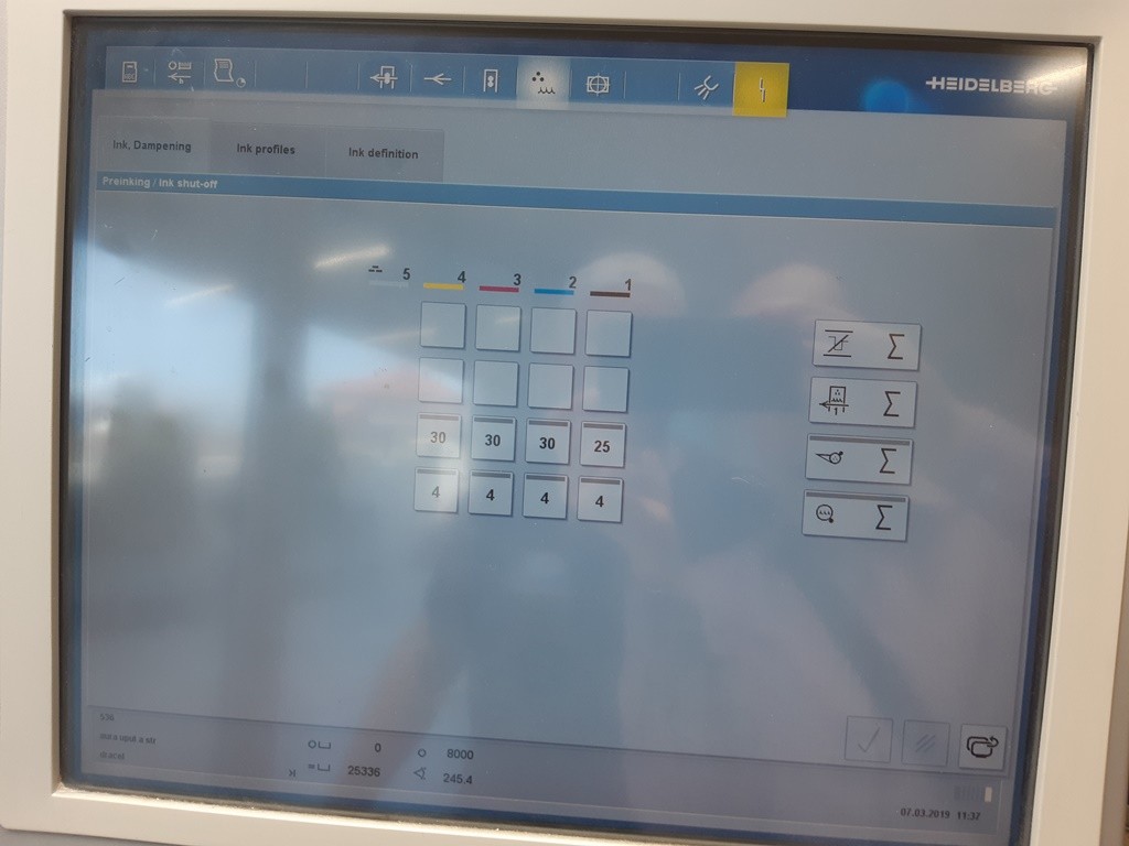

Predampening setting.jpg - 4 revolutions of dampening rollers before inking rollers are engaged
Pre dampening is set to 4 revolutions before engaging the inking rollers, increasement or decreasement didnt helped at all... This works fine with fresh imaged plates which are mounted at press asap, but not with 1 day delayed plates which are protected in boxes...

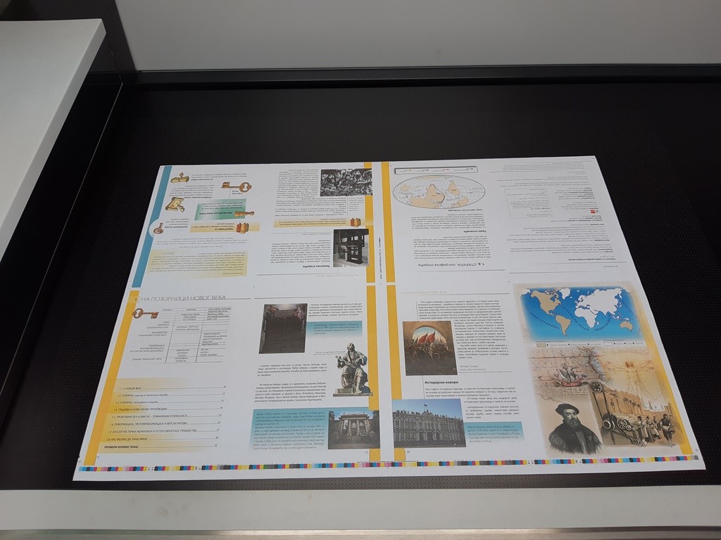

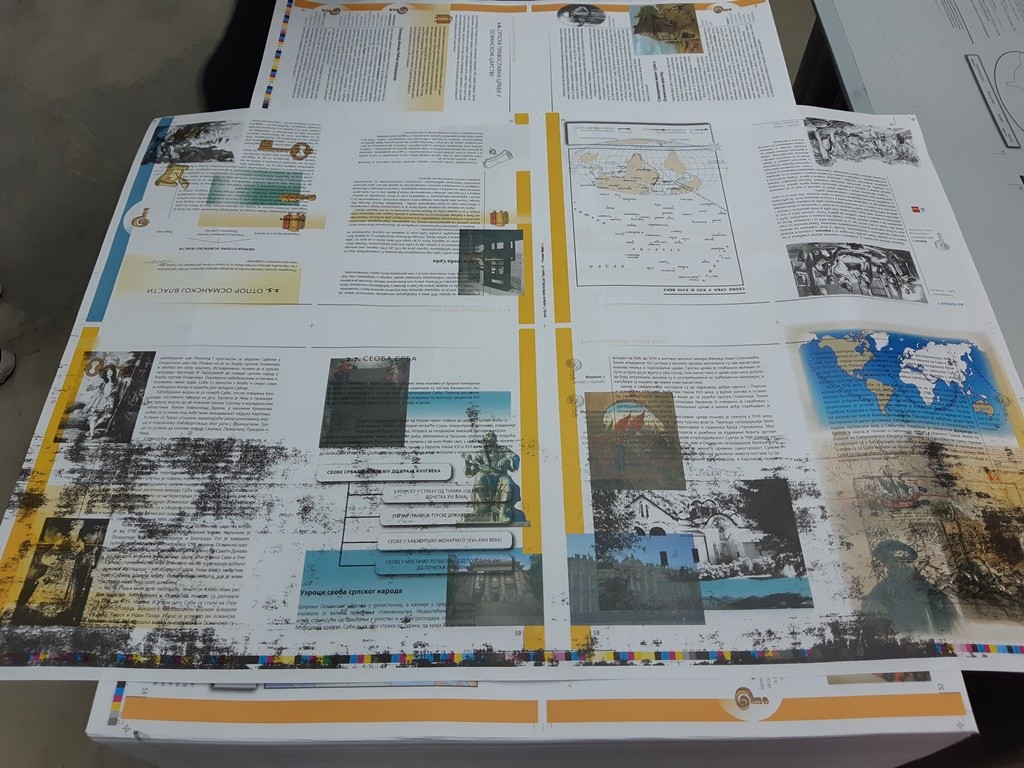

100 ti tabaka ploča stajala 1 dan.jpg - 101 sheets not cleared in black ink, 80 sheets with magenta, cyan, 67 with yellow ink Saphira Elite Star 610 - 1 day imaged plate before mounting on press
This is +/- 100 sheet printed with 1 day standing in box imaged Sonora X... Cyan, Magenta 80 sheets needed to clear, Yellow about 65 sheets
Ink plate wear.jpg - Plate wear due to non cleaned emulsion
Plate removed from printing unit, ink solidified non removed emulsion, needs plate cleaner with mid pressure to be removed - caution! Can affect oleophilic parts easily!

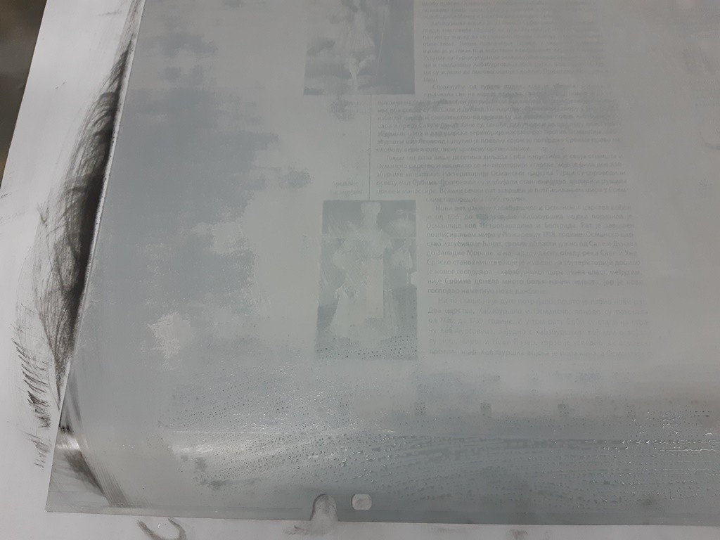

Ostala emulzija nakon 100 tabaka.jpg - Remained emulsion, not clasic ink platewear
As you can notice, remained protective emulsion remains on the places where ink build up was on the previous photo. So it is not a classic ink build up due to non proper dampening solution setup
As this problem still excists with the plates which are imaged and delayed in printing from some reason, what i could do is just make pressman continuously wet the plate for 30 seconds before print (druck) button / print start button is pushed, so all the emulsion goes in the dampening mixture unfortunatelly with risk to maybe on longer path totally clog the distributing pipes. Luckily customer already has practice to clean the complete system on month base with system cleaners.
Next image is sleared 1st sheet after press button is performed.
Sheet cleaned with 30 second soaking dampening sol. continuously with dampening ink form roller.jpg
1st image after "soaking" 30 seconds with dampening ink form roller
