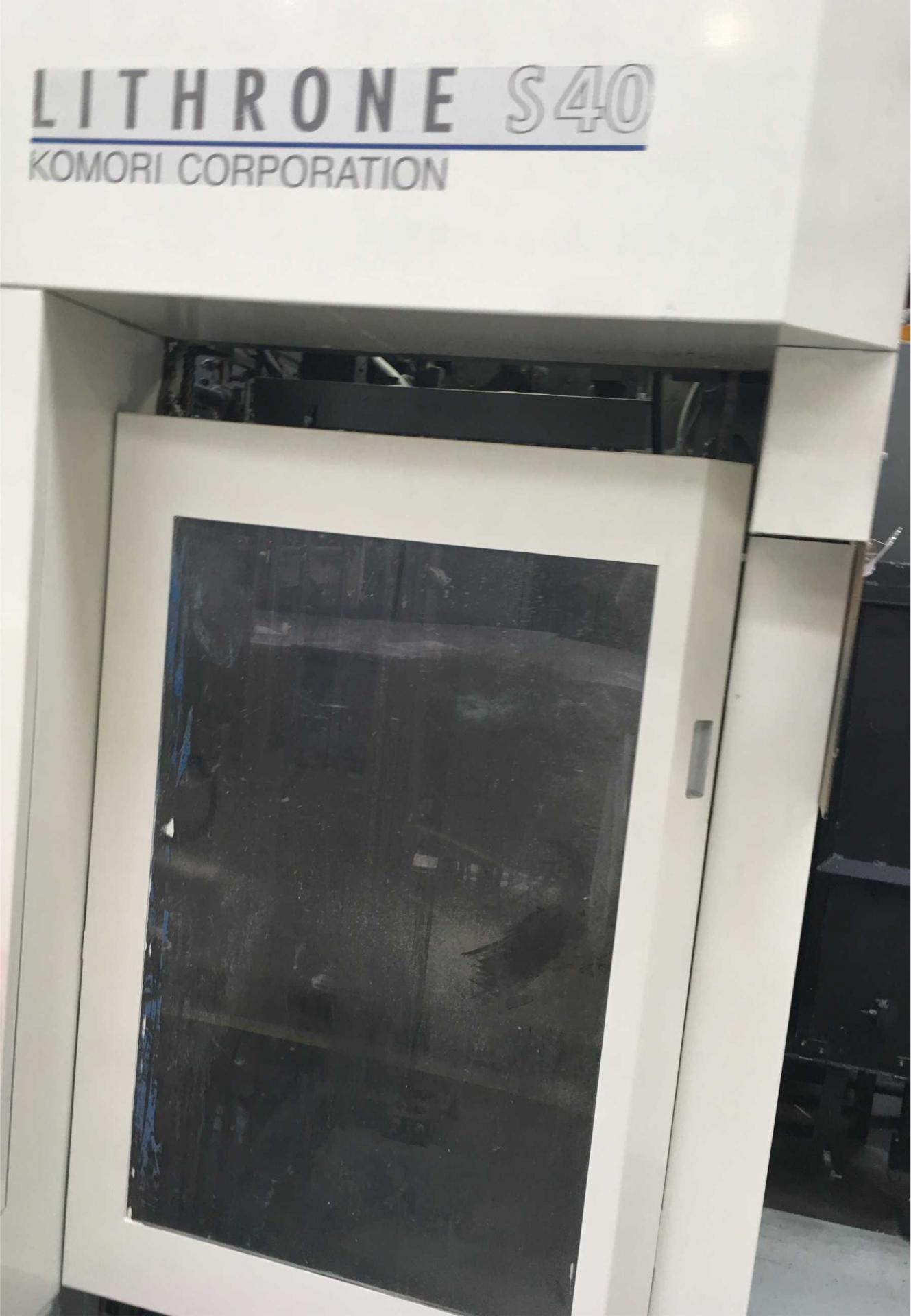

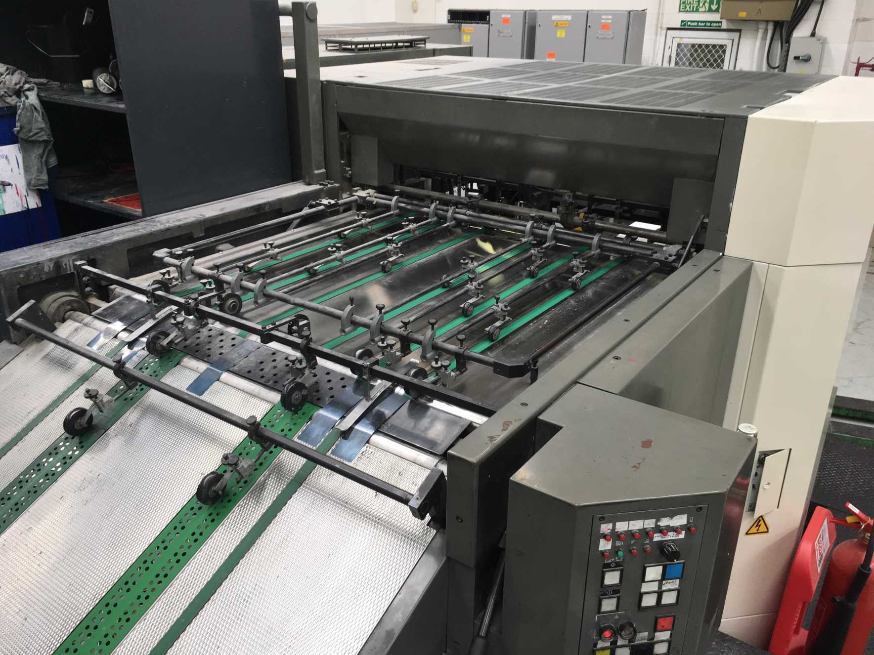

We are buying a 2002 Komori Lithrone S40 6 Color + Coater.
The seller tells us that the press has "Manual Non-Stop Feeder" and the picture given looks very different from other feeders I have seen (picture attached). Also the press comes with a "Double Delivery"
Does anyone have experience with such press? Is the feeder or delivery very complicated to operate or not so different from usual presses? Any problems with such Delivery or Feeder?

Dear Maas, thank you for the link..i understand better now how it will actually work.
but my question still remains why the double table between the feeding unit and first Print unit?
normally there is only one slanting table but as can be seen in the pictures there is first a horizontal table which then leads to the slanting one.

Looking at the photo it appears your press may be able to run 'Roll to sheet'. It does not however show all the other equipment needed such as the cutting head unit.
Your press may be able to either run ready cut sheets or cut rolls to desired sheet lengths.
That looks like why your press feeder looks different than a normal sheetfed feeder.

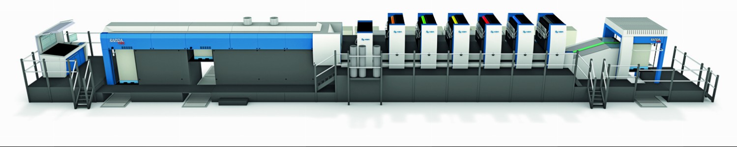

Thumbnail not our press but gives a picture of how much length is added for double delivery
Id be willing to bet that engineering a double delivery to do as I mention, would not be the limiting factor. My guess would be that Komori would not prioritize that feature more from a cost standpoint.
