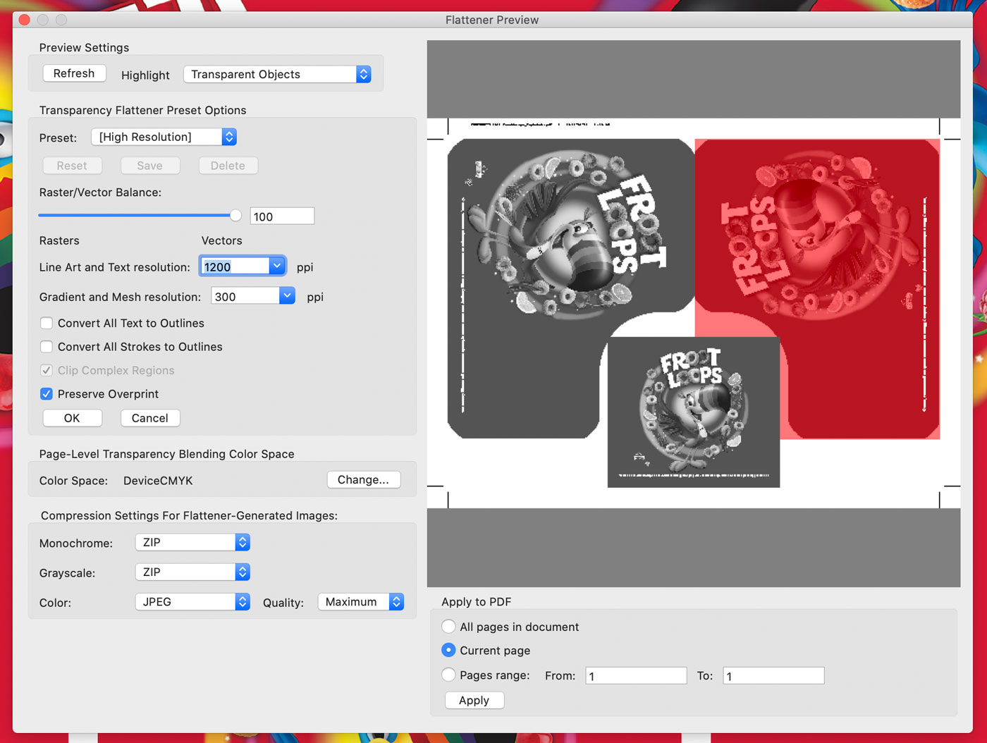

I've tested many iterations of PDF presets; working off PDFx-1a & PDFx-4 standards, nothing really works all that well.
Yes, flattening happens under x1a, obviously, but the the resulting CMYK looks flat and lifeless (at least on the Konica). However, because this job was supplied RGB (which the Konica seems to like better) I maintain our PDFs as PDFx-4, and then... the Acroabt Flattener works to best. Nice rich colour, no transparency for the Fiery to trip over. This tool is under the Production Tool set in Acrobat Pro. This is my only workaround, if anyone else a better way or my insight, I would appreciate it.

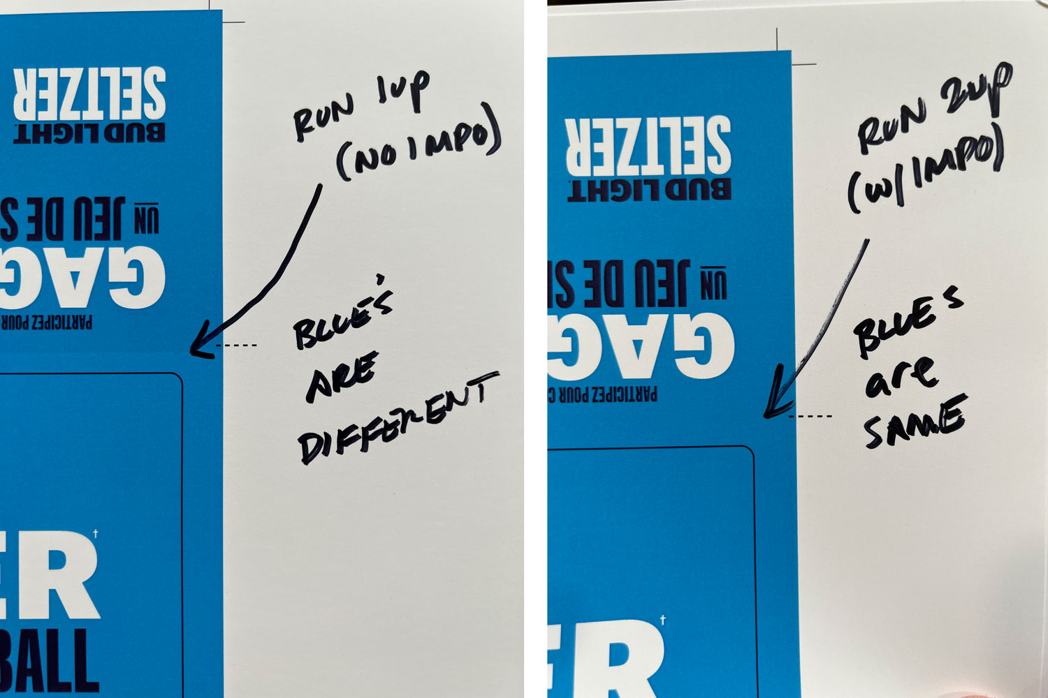

OK, more weirdness on a completely different job ...
Fiery processing colour differently if 1up or if using the built-in imposition for 2up. See photographs.
At this point there is something fundamentally wrong, we will seek out support from Konica.
In the meantime enjoy this head-scratcher...
i don't think imposition has color settings, so I'm guessing you're using hot folders which has a setting that is wonky?
How about this, select two jobs, one that you know works and one that doesn't to compare settings. If they have different settings, the setting will be blank. That might be the setting that's throwing things off?
RVNG
If by 'hotfolder' you mean dragging production PDFs into the job list area of the Command Workstation interface, then yes we use hotfolders.
You're right, the imposition does not have its own colour settings. After imposing, it simply makes another instance of the job in the job list, but with '.dbp' extension on the end. To which you choose your print properties: trays, qty's, finishing, etc.

The original Froot Loops job posted here was a good example because the two red areas touched each other. If not, the operator may have never known.
