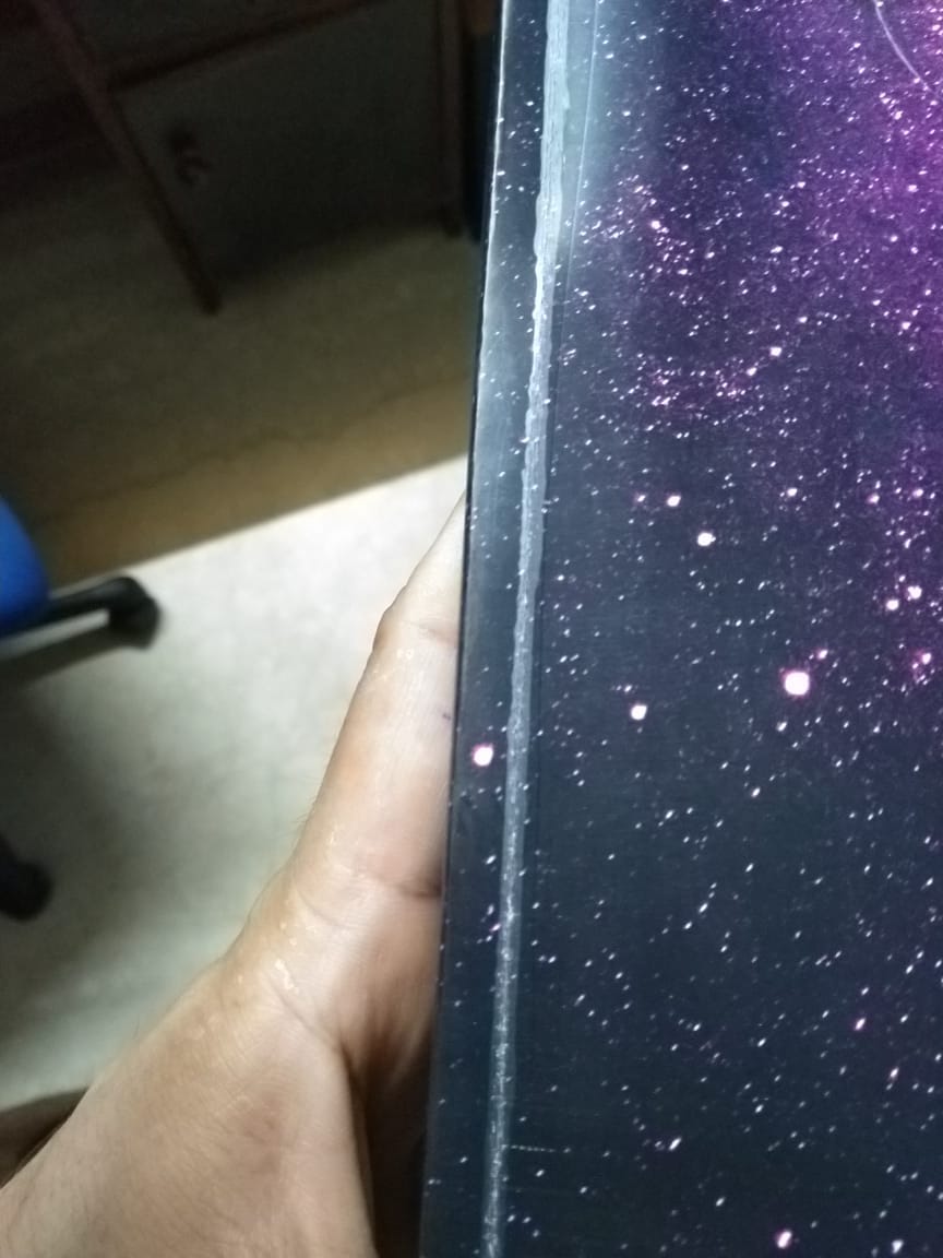

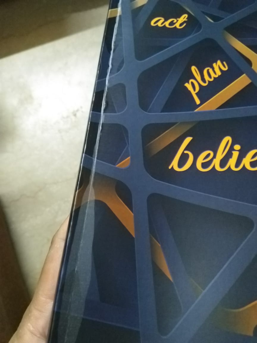

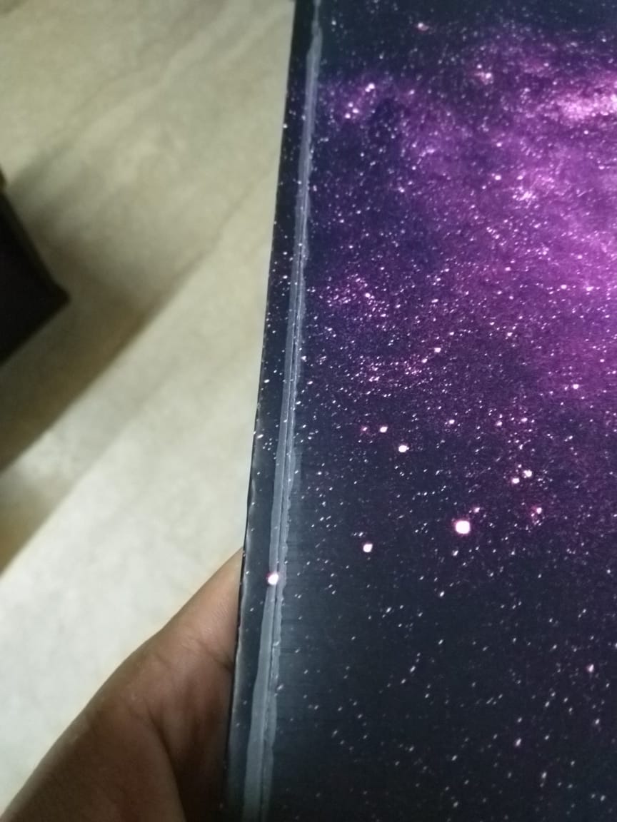

We are new into paper based stationery manufacturing and recently started manufacturing perfect bound notebooks. We are noticing that lamination is coming out from the area near the spine where the edge is formed when notebook cover is turned.
Please refer to the screenshots.

I've been researching the heck out of this lately (laminating covers) too as a precursor to getting into hardbound covers for spiral binding. A search on the forums turned up D&K Superstick Digital lamination as a possible solution. The explanation seems to be that the glue on the lamination has to penetrate through the toner and bond the the paper underneath in order to stay "stuck" which is tricky on full coverage prints. They're sending me samples to try.
I'm really interested in hearing how other ppl have solved this problem.
Delamination. We've been contending with this for years, using SuperStik film for a long time. We've had to run our laminator REAL slow to achieve 99% success. With more toner on the sheet, there's more of the possibility for the film to separate from the sheet in the same area you're seeing it.
Nobelus sells a SuperFlat™ Laminate DigiBOND. Apply at 250F and I have not seen any de-lamination problem.

We tried firing the heat gun on and near the area where de-lamination happened. The results were better, but the process would be very time consuming as we are talking about a job card with more than 100s of sheets.
How much lamination are you doing? We have found that wiping each sheet with an alcohol-soaked cotton pad is a workable worst-case solution. It seems to take the “edge” off and allow the film’s adhesive to penetrate the toner better. Not practical for high volume obviously.

Hi everyone,
We finally found it !
Here how we did it:
1. We ran the art cards at 125 degrees celsius and at speed of 5
2. We laminated only one side (the front side) and not on the back side
3. We reversed the creasing, that is, the curvature was made on the back side rather than on the front side
The results were great, only the creasing is seen when the card is bent and lamination is not coming out (just a tiny tiny bit).
