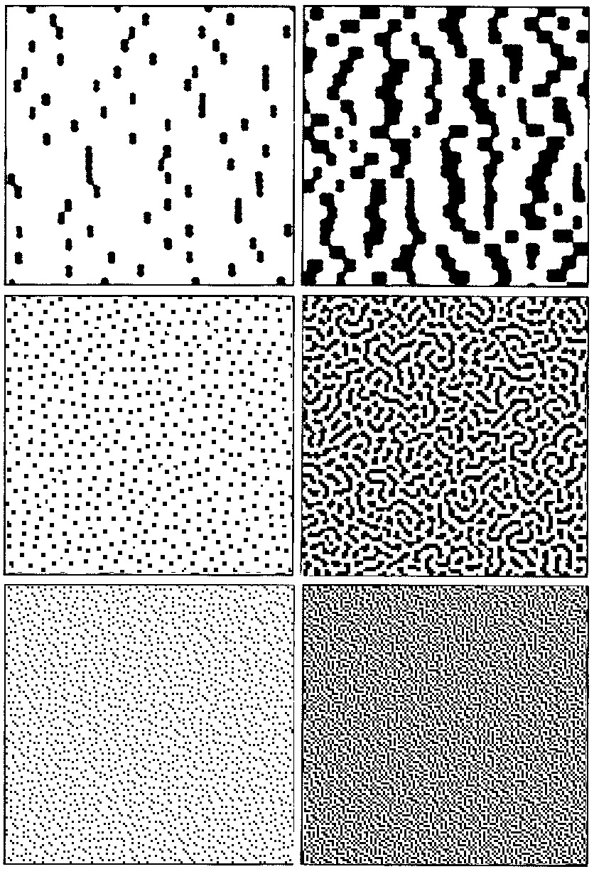

Just to make sure that the terminology is correct.
Attached are three images that contain two tones - 10% and 40%:
Scitex Fulltone - second order FM
Staccato (HDS, Taffeta, etc.) - second order FM
Generic diffusion dither - first order FM
These are not to the same scales but they show their typical dot structures. Click on thumbnail to embiggen.
best, gordo

Hmmm... that is an interesting thumbnail. I'm going to scan a couple of films I have, a fulltone and generic diffusion dither... I have a film from 1999 that is Fultone, it seems a bit different from the thumbnail, in that it doesn't seem to get 'fat' in the wormy line areas.
I'll try to upload the images later today...

Hi Gordon,
After looking at your thumbnails again, I think the fultone we have are both correct.
question:
1st order stochastic: dot size stays constant, more are added to fill density increases
2nd order stochastic: dot/worm size grows in size and scale, more are also added to fill density increases
Fultone stays constant in scale/size, just more are added to fill in density, yes?

Yes I think so too.
1st order stochastic: dot size stays constant, more are added to fill density increases. In theory yes. But as those same size dots get added they start to touch each other. When that happens (at around the 35% tone) then you get larger structures - i.e. halftone dots that are made of several pixels. See attached image.
2nd order stochastic: dot/worm size grows in size and scale, more are also added to fill density increases. Yes. First same size dots are added to increase density, then the dots start to grow instead forming "worm" like structures. The growth is controlled - depending on the design of the FM screen - in order to reduce visible graininess.
Full tone was a 2nd order stochastic screen where the dots were designed to grow primarily in one direction (axis) which formed wiggily looking lines. But the dots also grew in the other axis. So, to make darker tones the dots grew primarily in one direction while more dots were added and then the lines got fatter to make even darker tones.
Creo ended Fulltone when the bought Scitex in 2000 because Fulltone was not as good as Creo's Staccato. The main problem with Fulltone was that the dot structure was directional (the long wiggily worms). Halftone dots (of any kind AM/XM/FM) that are directional can exacerbate offset printing (which is also directional) issues such as slur and doubling.
