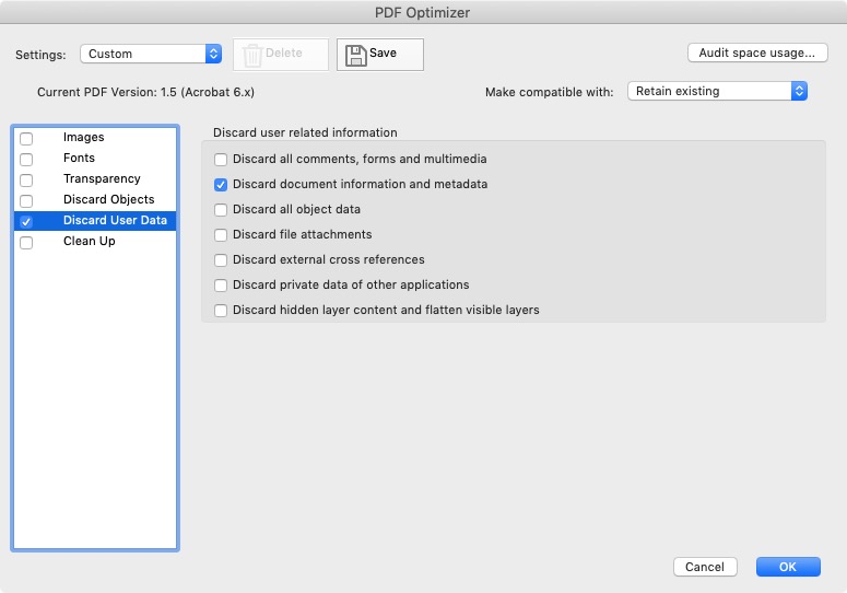

In Acrobat, click the File menu and choose Save As Other > Optimized PDF. In the PDF Optimizer window that appears, enable only the "Discard User Data" checkbox, then within the Discard User Data settings, enable only the "Document Information and Metadata" checkbox and save the PDF. On my computer, the PDF went from 13MB to 20K.
