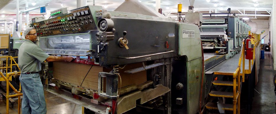

This press runs FM screening for breakfast cereal boxes.

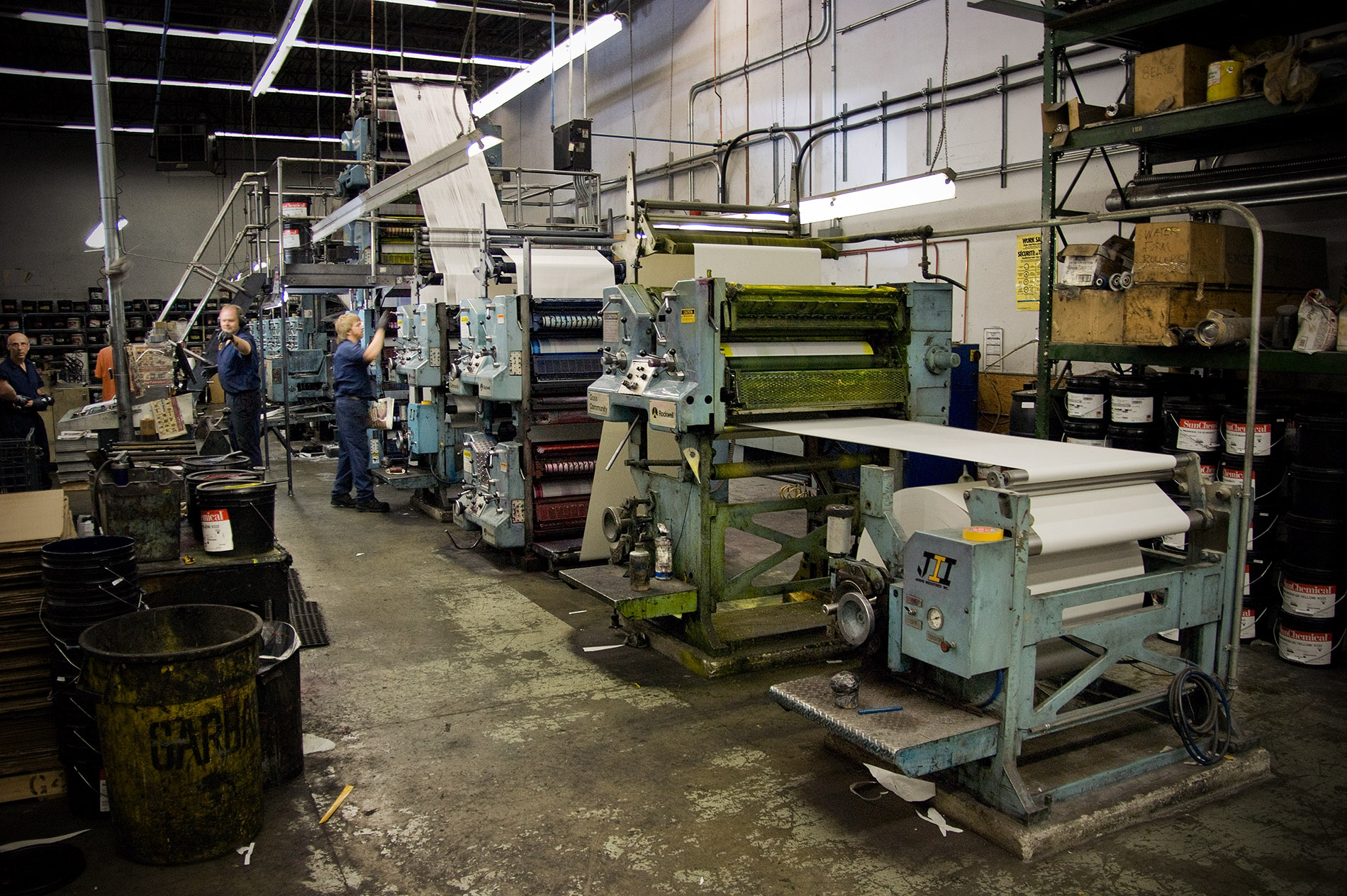

And this press runs FM screening for newspapers.

Their customers don't care about the halftone screening they use. They use FM because of the benefits in print production it can deliver versus AM screening.
