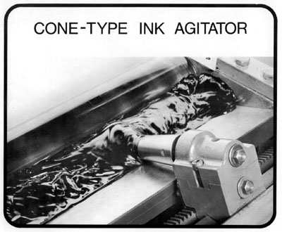

The solidifying / backing away in the corners is due to fountain solution traveling back up the ink train. More water tends to be run on the outside edges of the plate, this water overtime transfers back up the ink train to the ink fountain. Since the ink in the corners of the ink fountain doesn't get used, in most cases, it takes up the water and becomes emulsified. When magenta ink emulsifies it will loose its flow and body up. I would avoid, at this point, adjusting the ink to take up less water as this might create a different set of problems.
