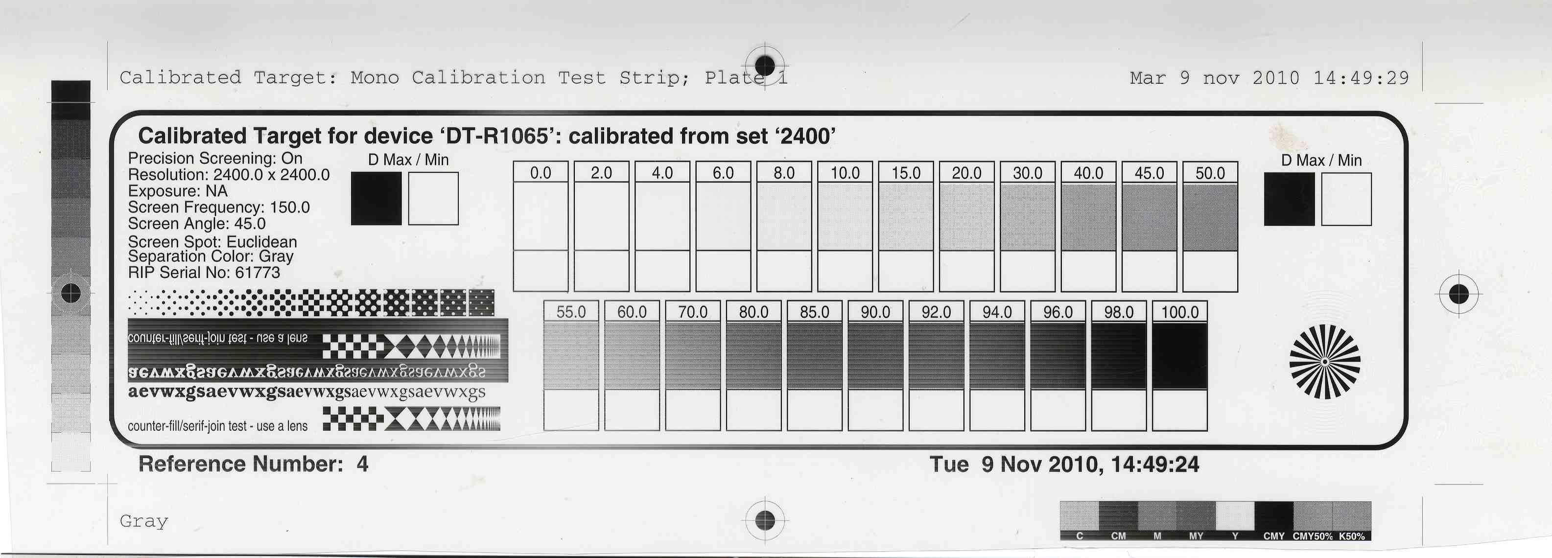

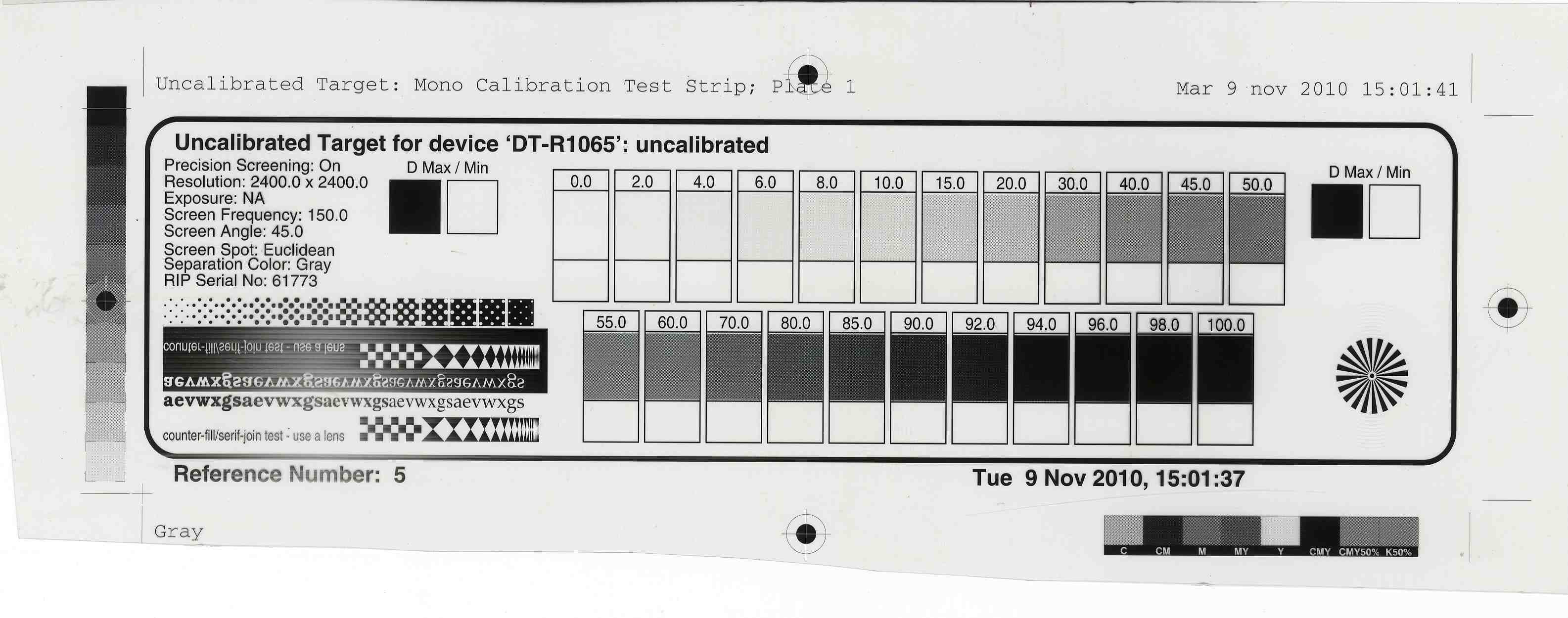

Hi,
Please can anybody help me with better configuration of DT-R1065(Light Adjustment,focus...) my job contain moiré.Please find attached job i have send to my imagesetter.Please help me i am stack.
Regards
Alexis NIWENSHUTI

my first reaction is: what dot type you are using? if this was color i would check the dot angles but this is black and white (composite) which makes me confused. Check what type of dot you are using.

This doesn't look like screening moiré. On the test targets, this looks an awful like laser swath banding. I.e. if it's a multi-channel laser the outside lasers are not balanced and stitching together properly. If that's correct, you will probably need an engineer to set up your laser properly.
A four color image screened and rendered in black and white will always show moiré because of the yellow plate - but that shouldn't be visible in presswork.
best, gordon p
Thanks Mr Gordon,
On your views ,do you thinks this issue is not related to resolution on the imagesetter or on RIP?
Thanks Mr Gordon,
No. I don't think this issue is related to resolution on the imagesetter or on RIP. I think it's a laser imaging problem (possibly combined with a processing problem). But it's only an opinion based on the low resolution images you posted.
best, gordon p

Laser imaging problems, not uncommon on Screen setters I've seen that more than once. Adjust the focus and zoom according to manuals or get a tech to dig in deeper.
settings i have on my DT-R1065
how could i adjust the focus and zoom ,i have these adjustment in manual but is not working,maybe is me who doesn't choose the better configurations
-Light intensity adjustement exposure(4064)
-Focus adjustment exposure(PT=34000,990,30)
-Light intensity parameter setting for the photo-material status is(F1/4064 LT=40%)
my film is Agfa
Please see if you can advise me the better configuration.
Alexis
My DT-R1065 settings
my film is Agfa
Alexis

Why don't you contact your supplier(s) and have them come to your shop and set you up correctly and teach you how to do it yourself?
