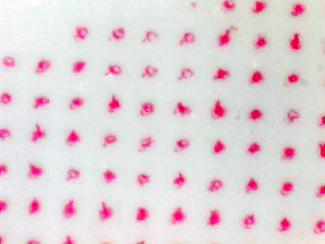

Trace amounts of calcium carbonate can even be found in some ink formulations where it is used as an extender. Higher levels are typically present in magenta ink. Calcium carbonate buidup on the blanket often shows up as a hole in the center of halftone dots - especially in smaller, or highlight, dots as in the example above.
