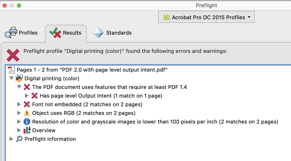

It's there. The 'Digital Printing' preflight profile had the check within it.
Thanks for the answer, ABC.
I did not know about the preflight option and indeed, it points out that there is a page level Output Intent.
Unfortunately, It does not tell you which profile is being used, only lists the existence of one.
I found some options in custom fixups to Embed/Remove page level Output Intents as well as checks if there is a page level Output Intent, but no list feature.
And then I noticed the general overview of the file (present in any check you can run).
It lists all pages and their respective content:
And there they are.
Thanks again for your time and your idea using the Preflight.
