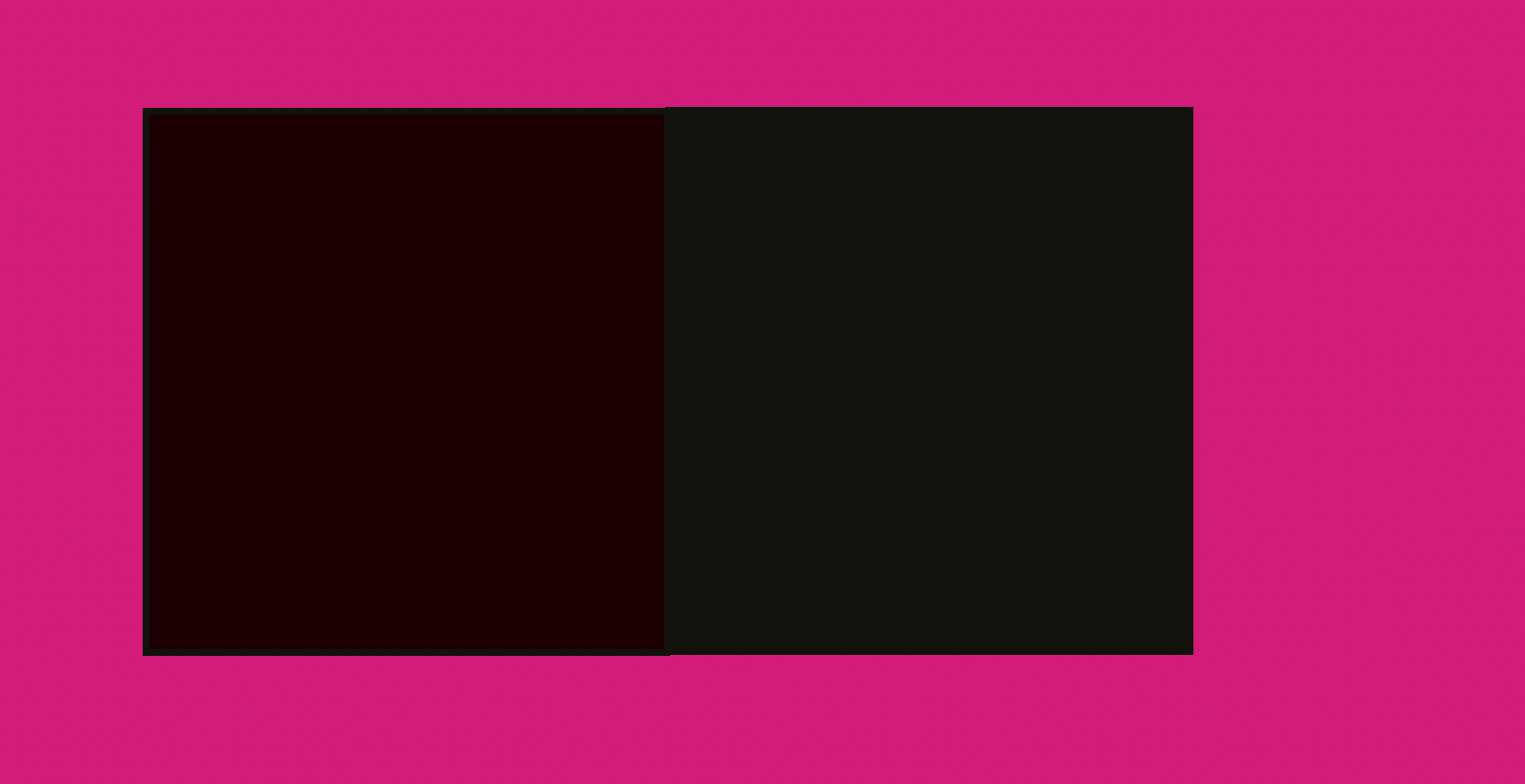

See attachment below, right 100% overprints 100% Magenta, left 100% does not Overprint.

I'm sorry, but I don't see the point if we only have one separation/channel. If it’s just Black, you really don’t need to overprint, don’t you?
It is true that as a general rule black text should always be defined with overprint, but in some scenarios we could say that preflight reports may contain "false errors" once interpreted by the end user. An example could be when they report black text is set to knock-out (no overprint), but that text is on top of "paper" and not on top of another color element.
