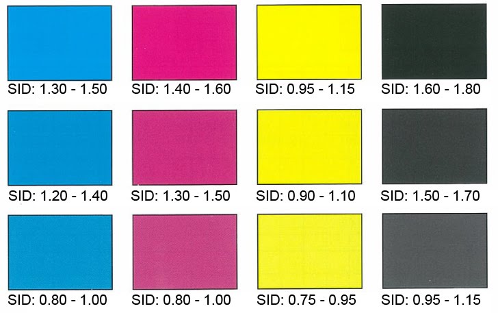

I googled a bit and I found this pic:
If these rectangles on the hard right show SID values for K=100%, I think that I get the concept.

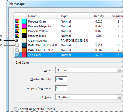

I wonder if this SID thing can be simulated in Acrobat's Output Preview. I found the Ink Manager there and I entered some values in it, but nothing changed on the screen. I don't know how it works.

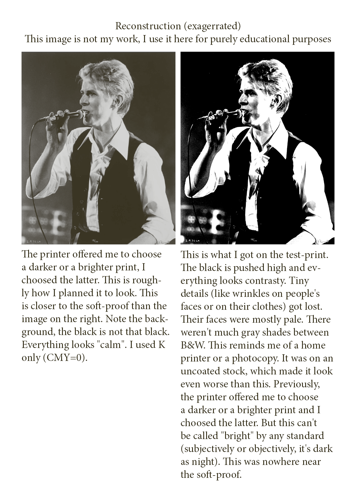

Now please check the pics below. Look at the one on the right. That's what happened to me once and I want to prevent it from happening again.
This is just a photoshoped reconstruction.
It was a proof supposedly from an offset press and it was too dark and contrasty:

The SID images you showed from top to bottom represent gloss coated paper, matte/dull coated paper and plain uncoated offset paper.
