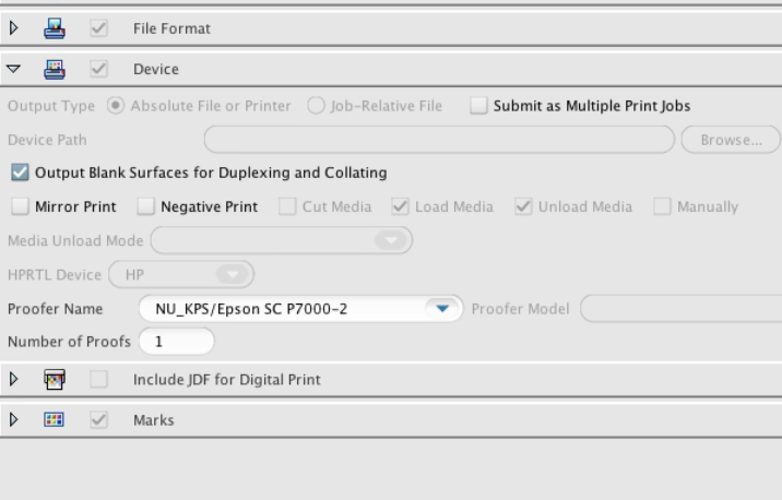

are you getting red X failure? sounds like device path has changed. Try typing with verified ip adress. Mine looks like attached
are you getting red X failure? sounds like device path has changed. Try typing with verified ip adress. Mine looks like attachedView attachment 292329
No red x failure, it hangs up and we end up cancelling since its stops all other workflow templates.
