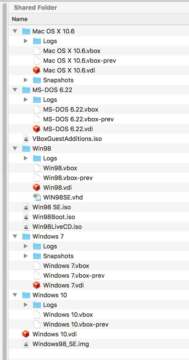

You do not have to partition the Mac hard drive for Parallels or VirtualBox. You do make a Windows partition to install Windows to but it is a virtual partition which means it makes a file on the Mac and you size that file to what ever partition size you want for windows but the windows "hard drive" is just a file on the Mac. Here is a screen shot of the virtual hard drives I have on my Mac. The assorted .vdi files are the virtual hard drives for my different OS installs.
