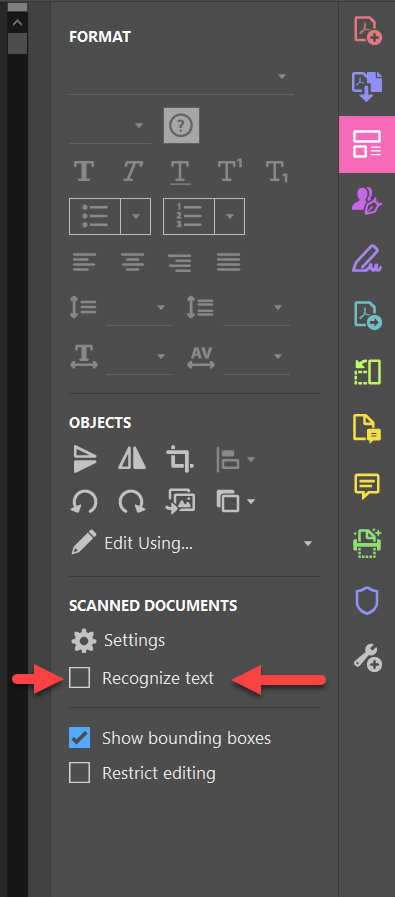

The second issue is that you have Acrobat configured to do automatic optical character recognition when you enter edit mode. This is set in Acrobat as shown below:
Ignore the fact that your file is not a “Scanned Document” – this Recognize Text function occurs if you try to edit a file, regardless of whether the PDF file is from a scanner or any other source. Anything that looks like text will be replaced with some (probably very wrong) font. Disable the Recognize Text option (it is sticky) and the problem will go away.

agreed. I fixed the original post so the URL now works - thanks for pointing that out as well. I had no idea that OCR would work on outlined characters.
