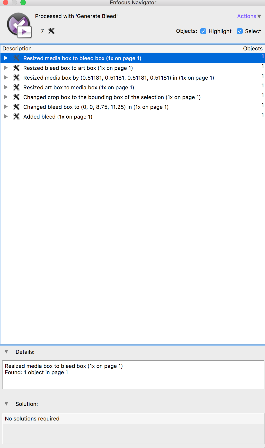

I still don't have a handle on this adding bleed thing. can you give a clue on what I did wrong on this? It ended up throwing it down to the left corner. They seems to work sometimes and not others. Or direct me to a video? - thx
