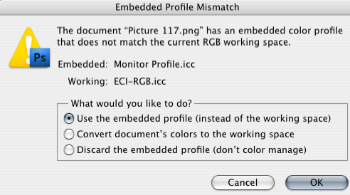

oh I was exporting to png, my file was ECI rgb, and seems to have that profile embedded in PS. Screen dumps usually have monitor profile attatched.
Yes, they do. And I can't quite figure out that behavior - it seems to be outside the spec.
If you are on a mac just open a screen dump in Photoshop to see that it has an ICC!
