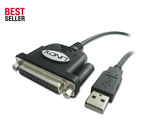

I've been trying to imagine the best way to make the data connection to the plotter. The plotter has a 25 pin serial connector. I would have to add a serial card to a workstation and connect the two with a cable obviously. Where I'm stumped is that most serial cards I've seen don't have Mac drivers. Most Illustrator work is still being done on Macs, is it not? I know this strays from my original line of questioning, but any assistance would be appreciated.
i think the problem is going to be like you said -- the parallel port connection. macs never really supported that well anyway; it was primarily a PC protocol when Macs when SCSI or serial or AppleTalk. there are some 25-pin to usb adapters on amazon and eBay, but like you said, check the driver situation for the *adapter* -- you might find that they're only available for legacy systems and you might be out of luck.
mojo - this is what's stumping me. Is the 25 pin connector by default a parallel connection? The plotter's manual mentions neither parallel nor serial, only DB25. This is an area I have limited experience in.
My plan is to:
- try to find a 25 pin to USB cable/adapter that'll work with a mac
OR
- put Illustrator on a PC (with potential font issues to deal with)

Hello Stickman,
Hope you had a good vacation. Mine starts Friday - whoop whoop!!
Plan to drink a lot of what D Ink Man has been having lately ;-)
Anyway ... A quick Google Search for "25 pin serial connector to usb" showed lots of adaptors. There is no guarantee any of them will work as this kind of lead is for very old tech output talking to quite old tech input. If you mac is really new, you might not even have USB 2.0 nowadays.
A quick look on Ebay will show that an old copy of Genuine Adobe illustrator CS2 WINDOWS - full version will cost you about 20 bucks.
You see you don't need the full colour artwork with all the fonts and text to cut. You just need the basic cutter diagram. Just a few lines. So any old PC with a parallel printer port connection and an old copy of illustrator is all you really need.
Hope that helps.

UPDATE - thanks to all who helped here, I am able to use the plotter for what it's meant to do. Through an ebay version of Illustrator and the trial of Fine Cut, I am producing live work. You have my sincere gratitude!
