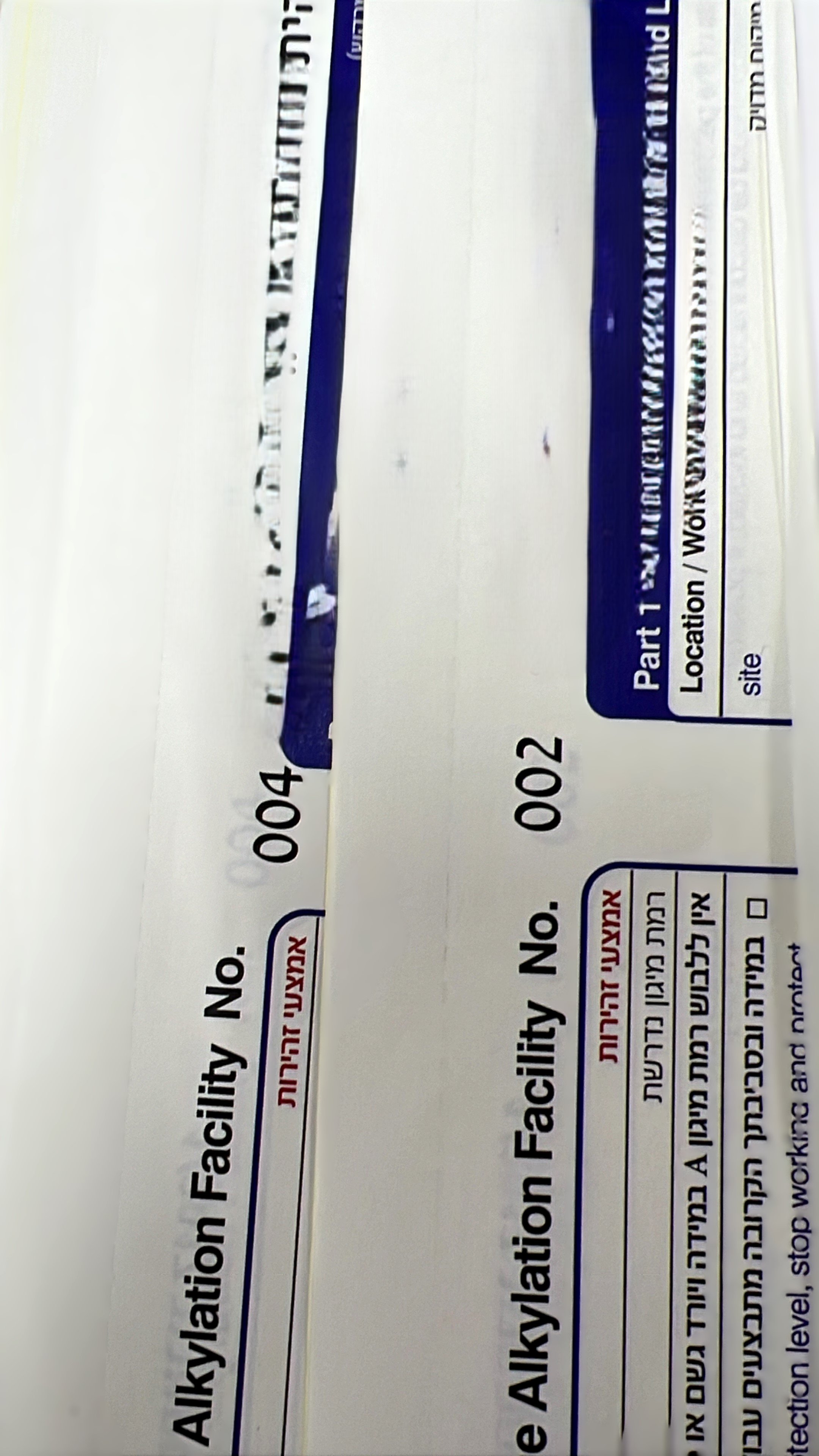

I am printing on the Iridesse 75GSM copy paper and then transfer the paper to the 9136 for numbering and printing other copy paper to make full binder in the end
When i print the number on the pre-printed the numbers always move up and down left and right never the same place.
It happens only when pre-printed paper is on.
The thing is that when i print from tray5 (bypass) the numbering is perfect but from the other trays (all of them) it moves
Any suggestions?
Well problem kind of fixed.
The tech guys did registration with SRA3 and not A3, After i did registration with A3 problem solved the numbers are still moving but not noticing it.
