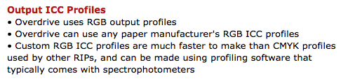

Thanks for your answer Nathan. From what I understand from ColorBurst documentation, output profiles need to be RGB and need to be made using third parties profiling softwares.
