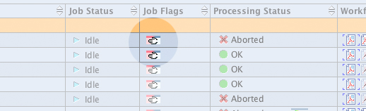

Prinect nubie question... On the Prinect GUI, some of our jobs are flagged with a little hand (see attached). When it has this flag it doesn't allow for new PDFs to be imported. I can do everything else but... does anyone know what the icon means and how to have it return to a normal 'fully editable' state?

Hand means that jobs need to be adopted, I believe.
Once you adopt the job, you will be able to do whatever you want with it.
Couple of times when we upgraded major versions, we've had to adopt bunch of jobs to make them usable in new version.

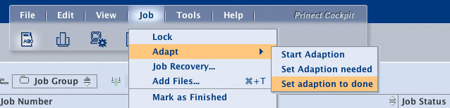

You adopt job by clicking on "Adopt job" in one of the menus that I can remember from top of my head, I am not sitting in front of the cockpit.
Thanks so much zoran! Right your are... with the job highlighted you go Job-->Adapt-->Set Adaptation to done (screen cap attached).
