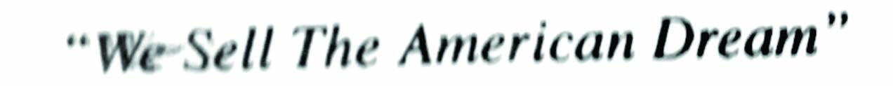

Pic sorry for the bad pic, if you look where it says "We" that's where the smear is.

Robert Cater,
What you are seeing is ............. Doubling - NOT smearing.
The Sheet prematurely slaps against the Blanket on entering the Nip, this results in
weak transfer of ink from the Blanket slightly out of register.
